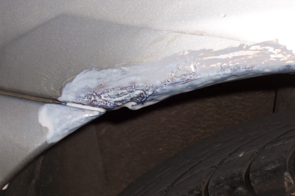

pic of the area covered in rust remover....
....and how the rust remover removed rust easily (after 5 or 6 coats and 20-30 mins between each coat. bad photo but it is down to the metal.

The rust will reappear within weeks. simply painting rust remover over rusted steel will do nothing. you should have ground out ALL the rotted metal and filled it firstly with a chopped strand glassfibre filler and finished off with a polyester paste filler prior to sanding and painting.
Also, to prevent the rust from returning oil should be introduced behind the repair(accessed from within the boot area) and underseal applied under the wheelarch :y

Yep, I think you'll need to attack the reason why it's rusted first then cut out any rust and rebuild it back.
However, what you have done will slow it down a little.  :y

Looks like you missed a rust bubble there, too (just to the right of the treated area)?
And yeah.. only one answer unfortunately.. hack it out with the grinder.

the way it should be done is grind all the rust away to bare metal,then use the rust converter,wash it of with plenty of water,then use your filler,when its dry sand it down,then cover wih etch primer,then use filler primer,rub down with some fine paper then spray top coat.
as said before if you can do the inside as well you on a winner.
