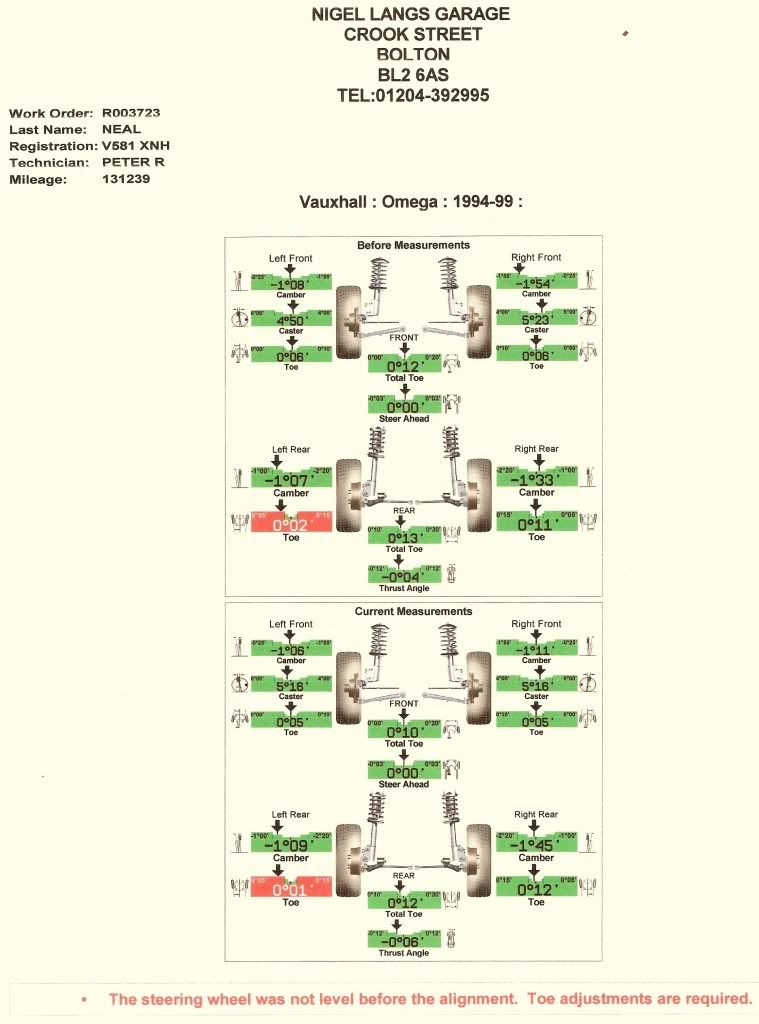

well i spent a couple of hours there this morning needed a nearside trackrod, and a new tyre front offside. but delighted with the results she has never in my ownership handled so well or felt so smoth.
well worth it £68.00 to omegaowners.com plus any other parts needed.
the results on paper
i dare say it will mean more to some of you, as i say now drives the way it should.

Could they not adjust the rear?
I assume they moved the subframe to?

the near side rear was solid even after heat and big hammers, and you are quite right they did move the subframe to get it right
