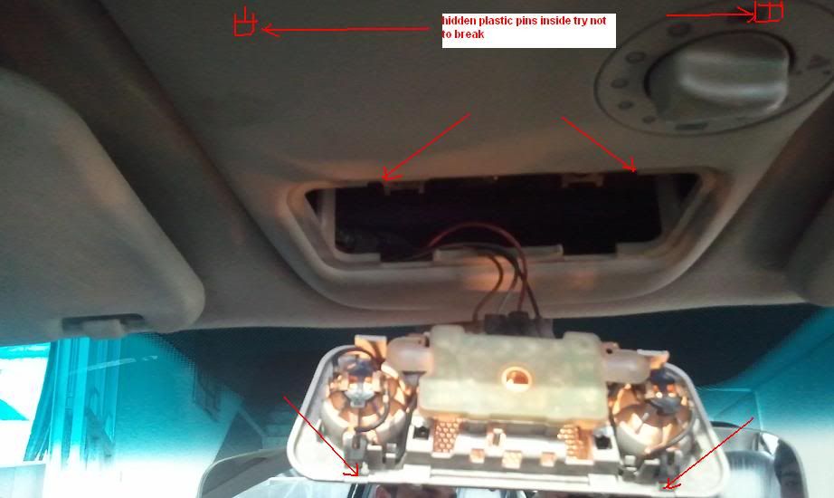

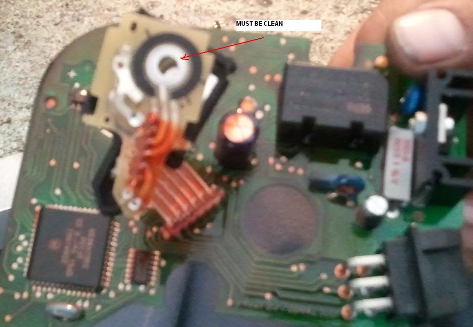

today serviced the sunroof as it was behaving with its own mind..
find this thread really useful
http://www.omegaowners.com/forum/YaBB.pl?num=1247486519
these pictures also may be useful for someone who want to service it.. if admins find them appropriate , please add to the related thread..

update: after cleaning the sunroof internals and changing the bulb, turning on the heaters have no effect .. its been a rainy week here and the sunroof remains silent..and behaves like a good boy ;D
