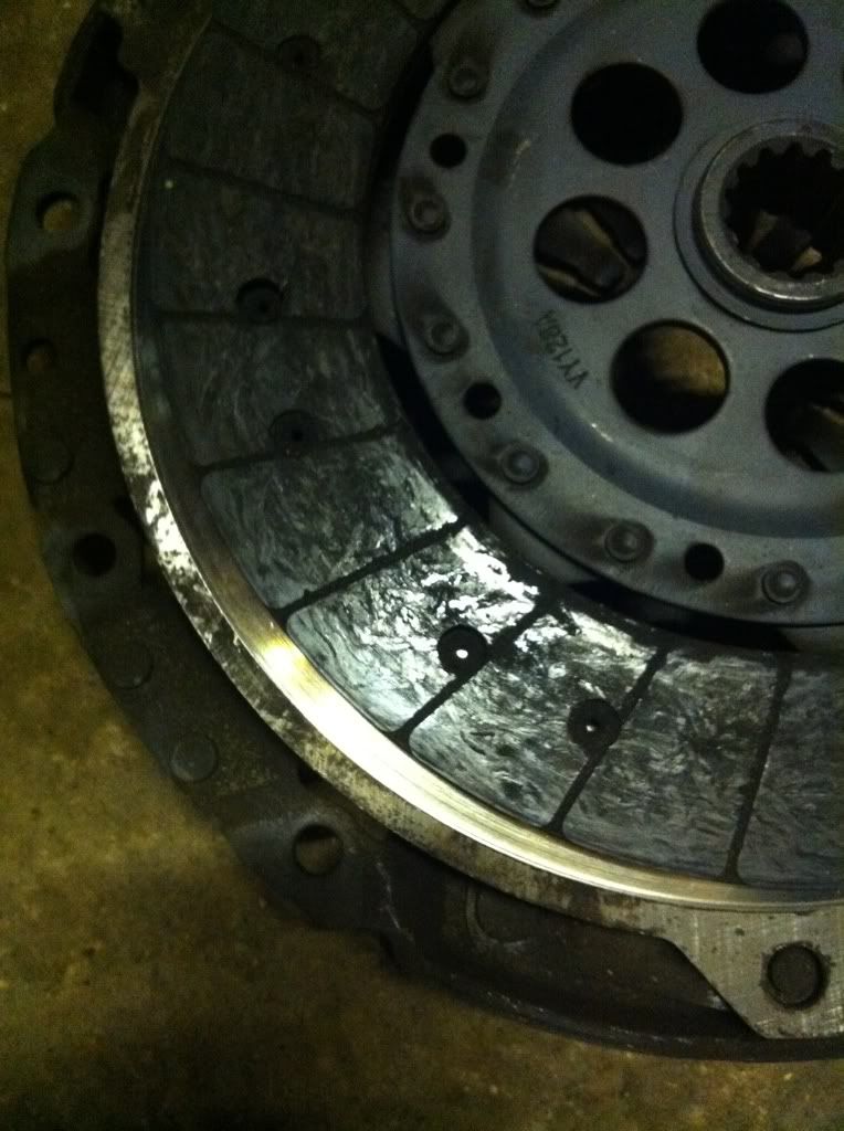

Some of you may remember i had a new clutch fitted last year by Mr clutch and it has been nothing but trouble since, a very persistent judder, even after a warrenty replacement. Anyways I set off down the road yesterday it was slipping like hell. Not the first time it's done this, when it had done before I'd put it down to a diesel leak contaminating the clutch face.
So when I got home, I ran the car up on the skids to look for any offending fluids, there were none.
So it's spanner time. Gearbox off. The clutch looks ok, bit of glazing but other than the fact that mr clutch used a cheap crap copy clutch I am clueless!! My line of thought is replace it with a valeo or something. Matey reckons the judder may of been because the pressure plate was bolted tight with airgun, =torqued up uneven=cause of judder.
Suggestions welcome, besides a visit to mr clutch late at night with a stolen 4x4 ;-) lol

Ok I bet you are wondering eh,
New clutch fitted by me.  Here's what they done.
They had fitted the smaller (incorrect, and cheaper) friction plate to the other gubbins that were already on the car. They (badly) re-faced the pressure plate, and charged me for a full kit. Even for the slave, which I SWEAR they didn't change until I went back and got (supposedly) another clutch fitted on warrenty. Tossers.
They are cowboys still, even after an appearance on watchdog!!
Anyway I lodged a complaint with head office, waiting to hear the outcome.
Will keep you posted  :y
