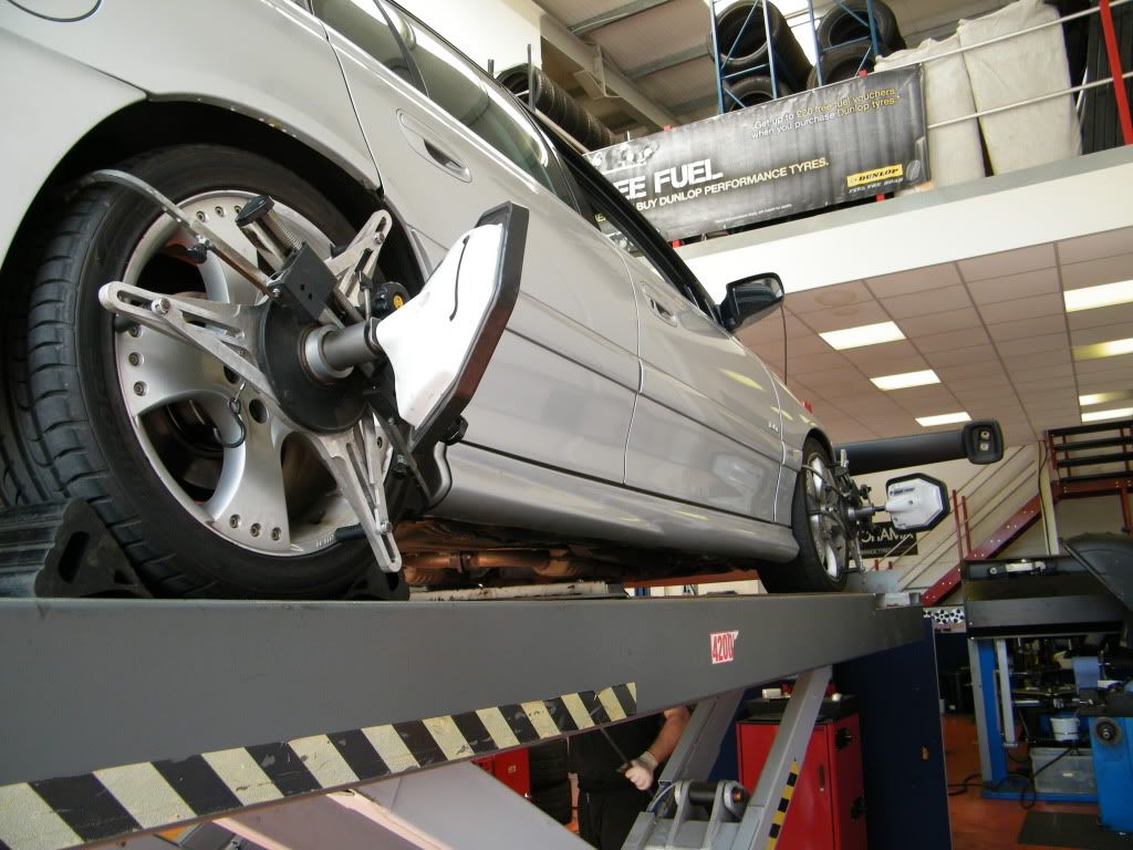

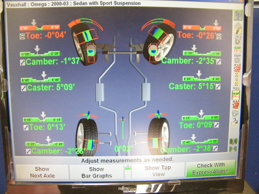

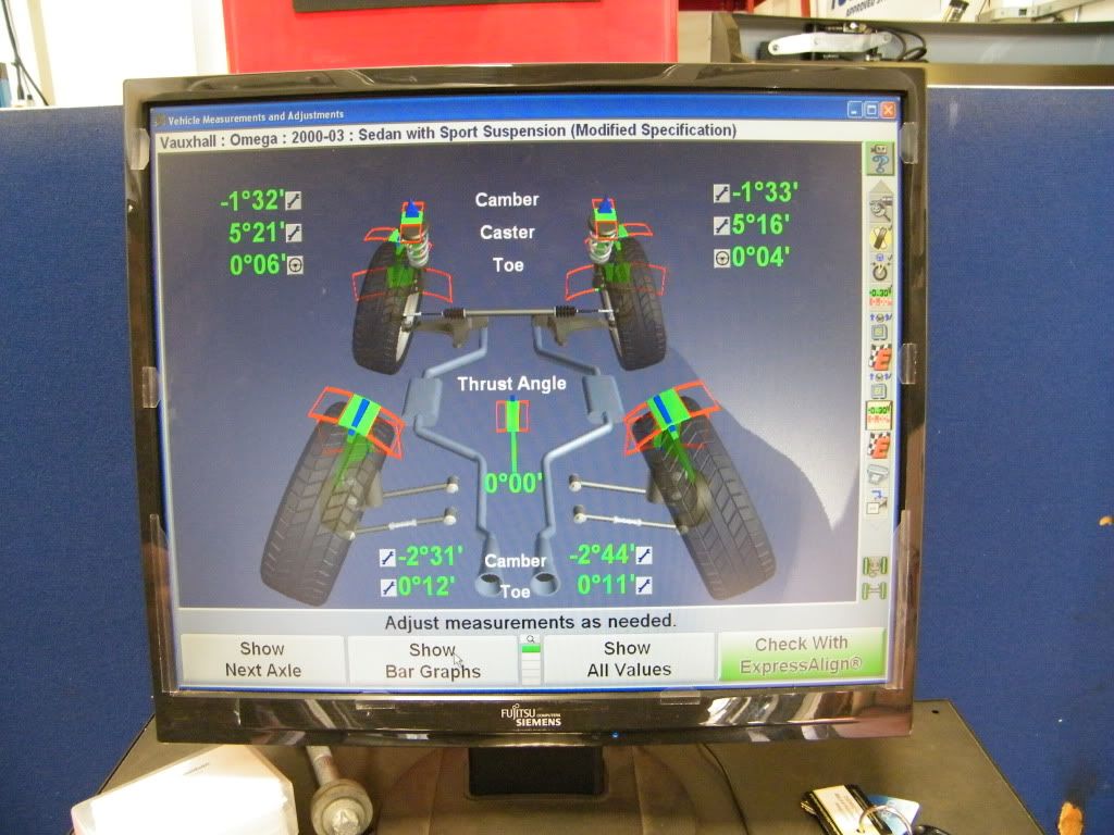

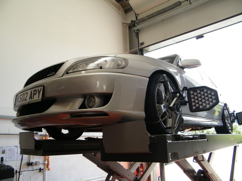

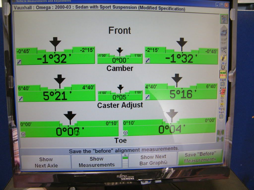

Well I took the car to Wheels In Motion Yesterday and the car feels great now, I had the full geometery done and 2 new front tyres.
BEFORE:
AFTER:
DURING:

the guy who did it definitely knew it had lowered springs.
We had a chat about it.
Also, he couldn't adjust the rear toe at all because they were completely seized. but said they were almost right, and both had toe in, so could be left.
And of course the rear camber is not adjustable as standard.
Fronts were wayyyy out..
Toe was really far out on both sides, hence chewing through a set of tyres quickly.
Camber was about 1'10 on the right and 1'23 on the left, so he brought the left one out a touch more.
And they evened up the Subframe to get the caster more equal.

« Reply #13 on: 06 July 2011, 11:18:13 »
I'm pleased she's driving better..... The reason -1d 30' was set was the OSF camber adjuster maxed out, but it's far better than the -2d 30'.
