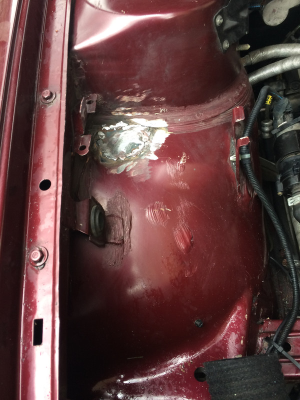

Quote from: Migv6 le Frog Fan on 23 September 2020, 18:20:10
Cut out a small piece of rust under header tank (so top of inner wing/ wheelarch) and ended up with a hole the size of a £2 coin.
Welded a patch over the hole and repainted the area.
Need to underseal the underneath of it, but that will have to wait for a drier day.
As Im posting pics in another thread, might as well show off my lack of welding skills on this one.
As Webby says " A grinder & paint, can make a welder what he aint".  :)
