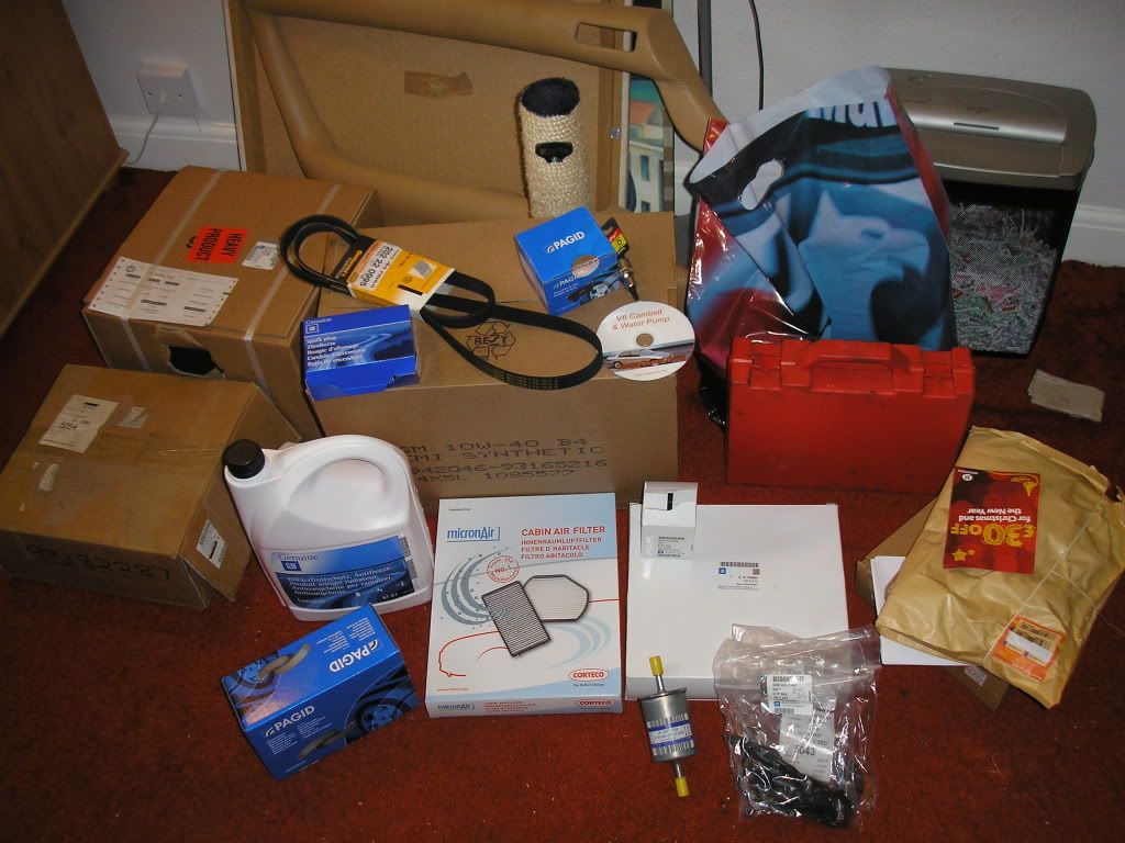

over the next week or so I will be keeping a log of all work carried out, including the costs of each job and how long it took me to do each one, (I'm a very basic home DIY spannerer with basic kit) Hopefully this will be some help for those either looking to buy an Omega, or those that have already bought and are thinking of doing these jobs themselves.
As you can see I already have most of the parts that I need. As I do each job I will list how much the parts and sundries have cost me. (please excuse the mess in my office  :-[ )

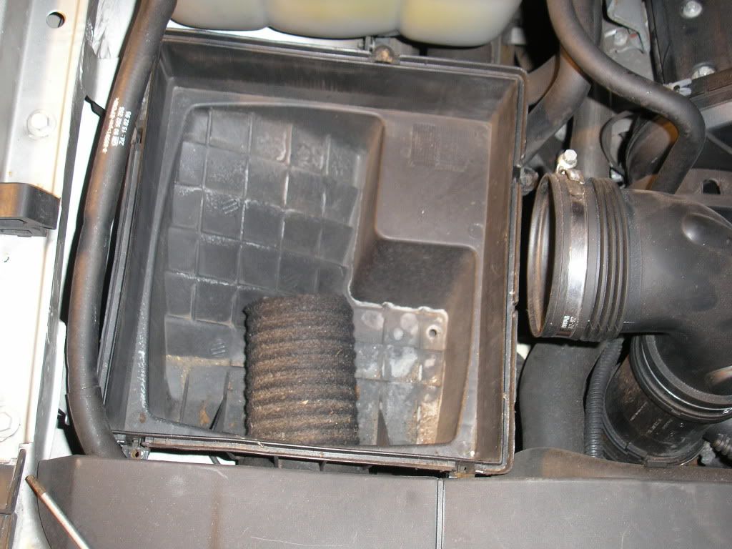

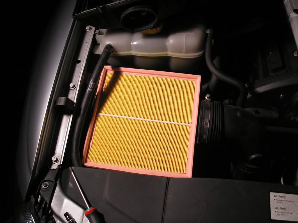

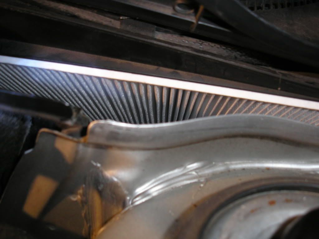

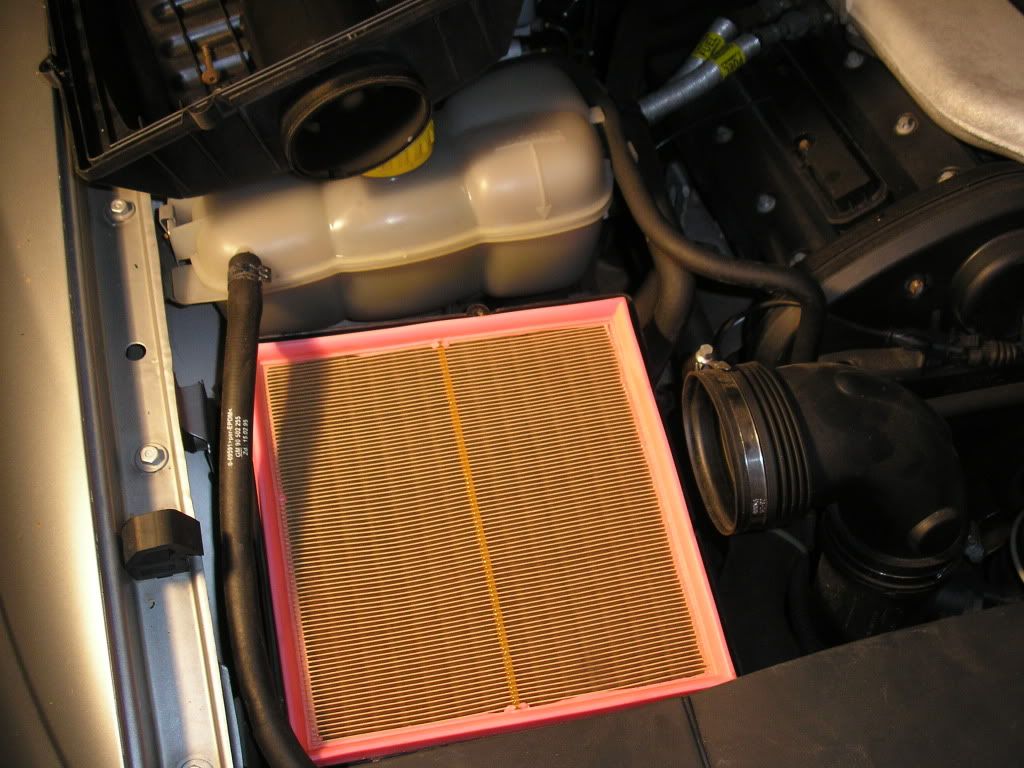

Airfilter. A new one from the main dealers cost me £11.66 inc VAT. Fitting was a piece of cake. If you can open a can of Coke then you can change an air filter and a pollen filter.
Tools needed for the airfilter change are a T-20 Torx drive, 1/4" ratchet, extension bar, 7mm socket and a vacuum cleaner. The job took me about ten minutes.
Old one in;
Old one out. I gave the airbox a good vac and wipe out at this point

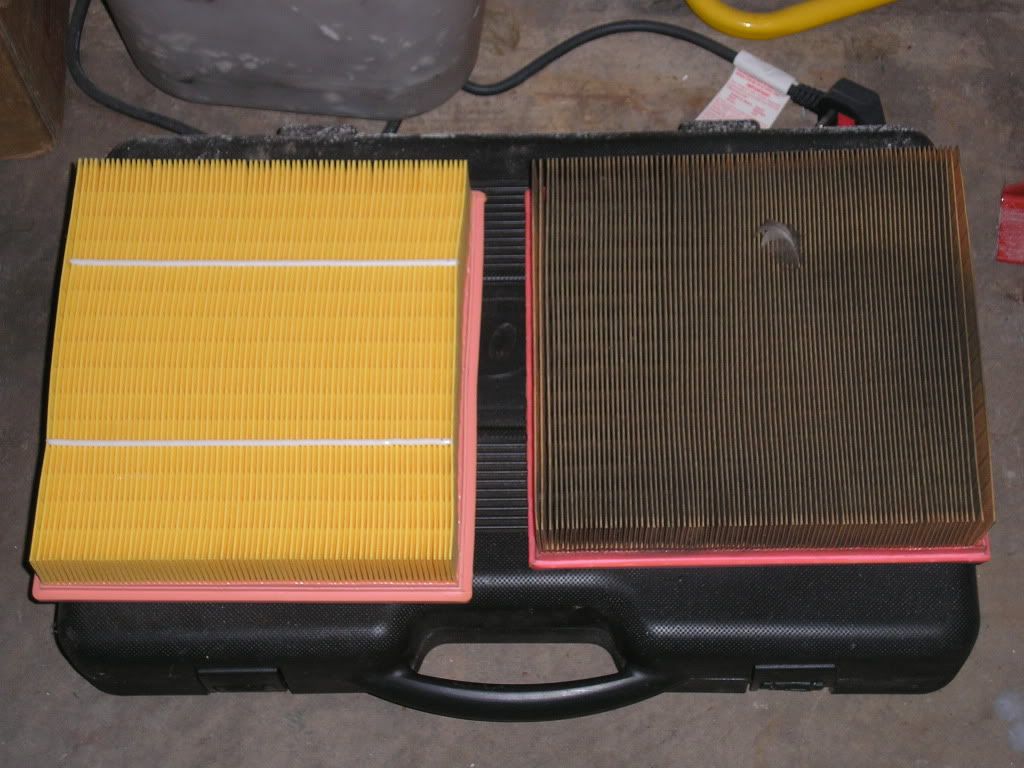

Old v New
New one in
Job done.

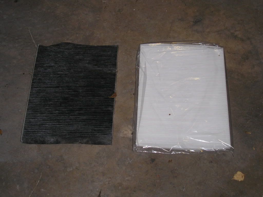

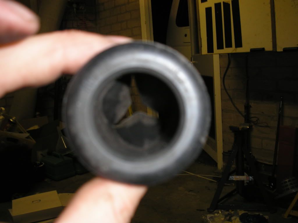

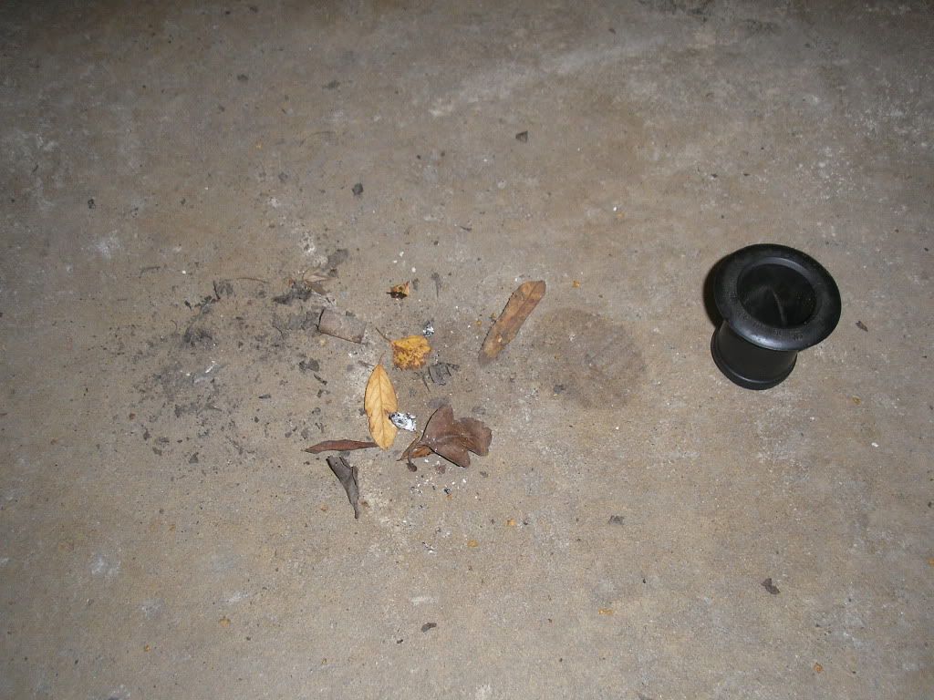

Next up was a clean of the drain holes and replace the pollen filter. Yet again it was a pretty easy job. The only 'tools' that were needed was the vac (again) and a 1 metre length of stiff 'twin core' cable to help clear the drain holes. My pollen filter was £7.44 inc VAT.
I used the excellent scuttle drain guide in the maintinance section of this forum as a guide. I found the retaining clips hard to locate at first, (it wasn't obvious that the clips were clips). Clearing the nearside (on UK models), drainhole was tricky due to how little room there was for me to force my hand in. I must admit to having to get the wife to help at that point. My hands were just too big. The drivers side was a piece of cake.
Drain hole cleared
Old v New pollen filter
New filter in
The grud that came out of the drivers side drain grommet. Well and truly blocked!
And grommet cleared and cleaned.

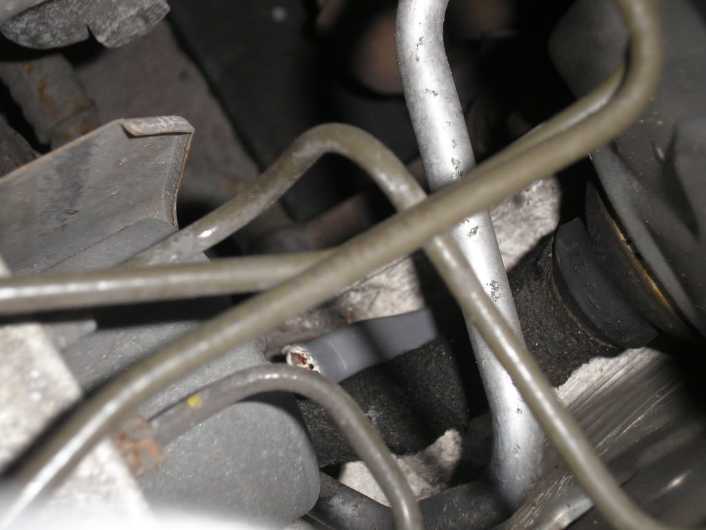

What spare time I had yesterday was taken up by doing just one side of the rear brakes. Discs and pads wasn't a problem, but what did cause a major delay was getting the retaining pins on the shoes back into their cover-plates, (if you know what I mean?).
The pin nearest the front of the vehicle was slightly shorter than the one towards the back. Not by much, only a couple of mm, but it was enough to make an already fiddly job neigh on impossible  >:(
For anyone who is thinking of changing the handbrake shoes, may I suggest that you include the following in your toolkit,
These very thin and long forcepts from Machine Mart; http://www.machinemart.co.uk/shop/product/details/forceps it will be the best £4.69 that you ever spend. I just wish that I had had some prior to doing the first side.
Plus a large and varied selection of swear words to use when the bloody spring pings the pin back out at you for the 417th straight time.
Today has been stupidly busy at work, so all I've had time to do is clean up my rear wheel, (it was completely black on the inside), which took some doing, then make a start on my front discs and pads. The fact that the caliper to bellhousing bolts are seized solid has drawn things to a close today. Just as well as I didn't notice that it was 02:50am.
if I thought that the rear brake linings were bad, (down to the metal), it was nothing compared to the fronts. I honestly do not believe that the discs or pads have ever been changed in seven years and 94'000 miles. No friction material left on the pads, everything is seized solid with what looks to be factory thread lock on the couple of bolts I have removed, but it's the front discs which worried me the most. Between the vanes is so badly worn and corroded that they are well on their way to splitting in two  :o
I've seen some seriously worn discs in my time, but these fronts really take the biscuit. Thankfully I only had to drive the car about 15 miles to get it back home.
I'll post up pics tomorrow so long as I actually have the time to work on the car, and I can get the dam caliper retaining bolts off after using so far half a large can of TT without any joy.
