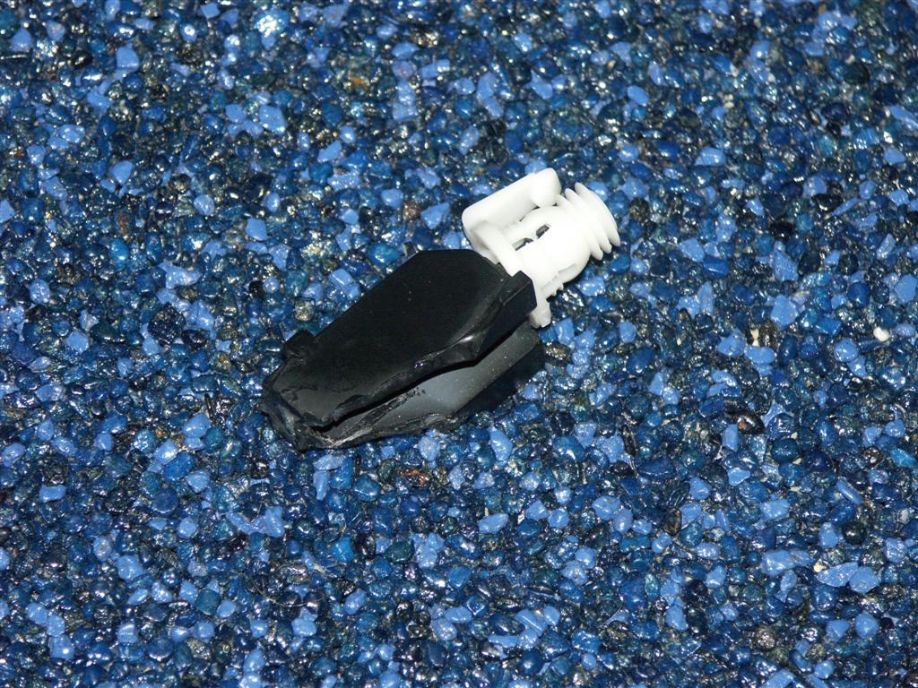

I have need of 2 of the black plastic headlight adjusters, mine have both shattered. The ones that always break! I dont really want to stump up for new headlights just for these, but I do understand they will be hard to get as it is a common fault, but I thought it would be worth a try.

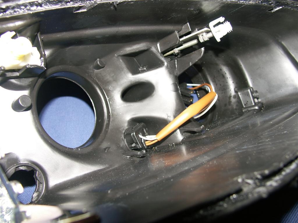

do you mean the headlight adjusters inside the headlight?
Like this one:

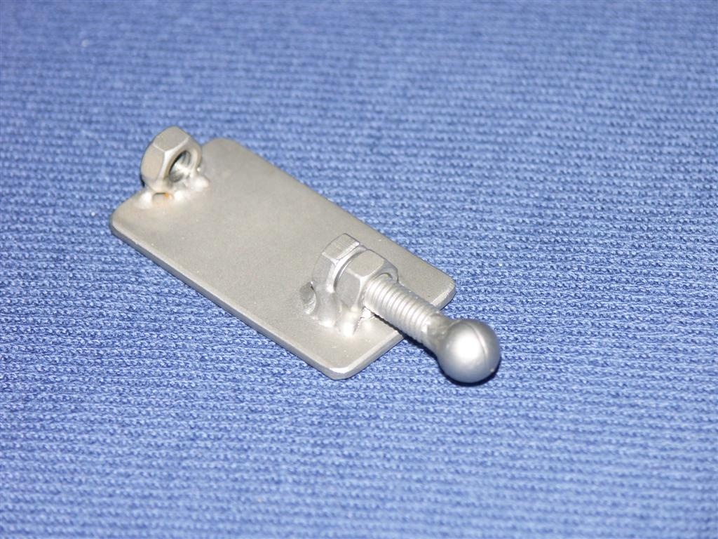

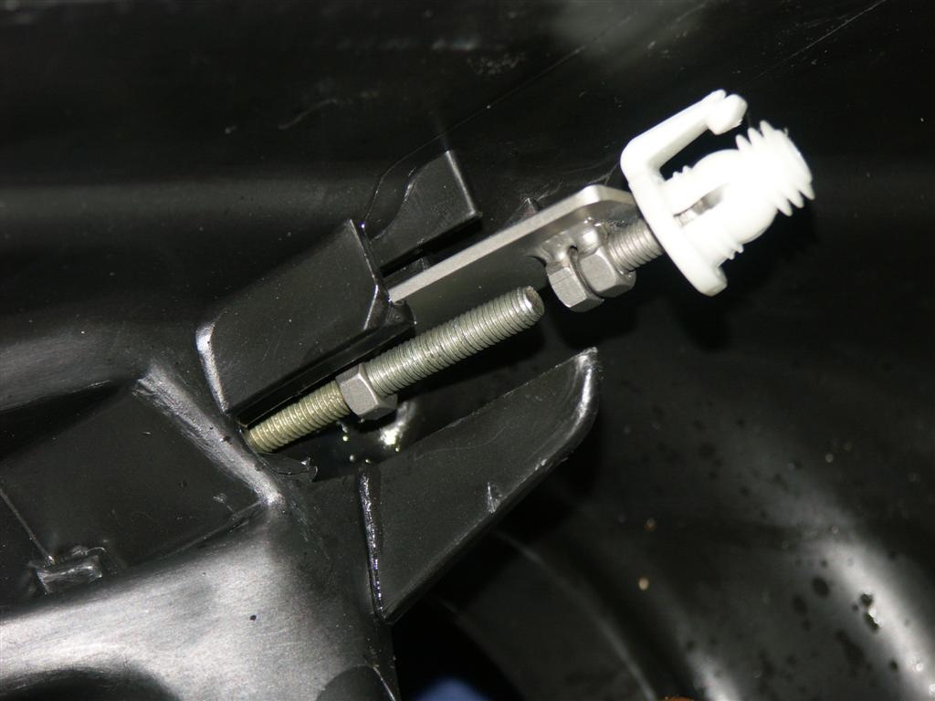

If so; i created a replacement for that:
[media]http://www.youtube.com/watch?v=3wLgf8BmNHk[/media]
That looks to be a excellent replacement! Any chance of some sizes/drawings? I repaired mine with epoxy glue but yours looks far superior & long lasting idea!

@ al: I am busy with another friend, who said they did not fit his headlight. Perhaps I have to redesign this solution. How urgent is your request?
I am willing to create several sets and help out my fellow Omega-lovers (of course at a reasonable price).
@ Andy: like stated, I have to redesign the model... but I could measure this unit for you.
Are you able/have the possibility to weld stainless steel? Because all components are stainless steel (incl. the ball; it's from a SKF bearing  ;D )
I do have the facilities to weld stainless & if I'm making anything for myself at work I always try to make it out of shiney stainless steel ...... it'd be rude not to!  :y
A ball from a bearing ....... brilliant! ;D  ;D  ;D  :y :y
