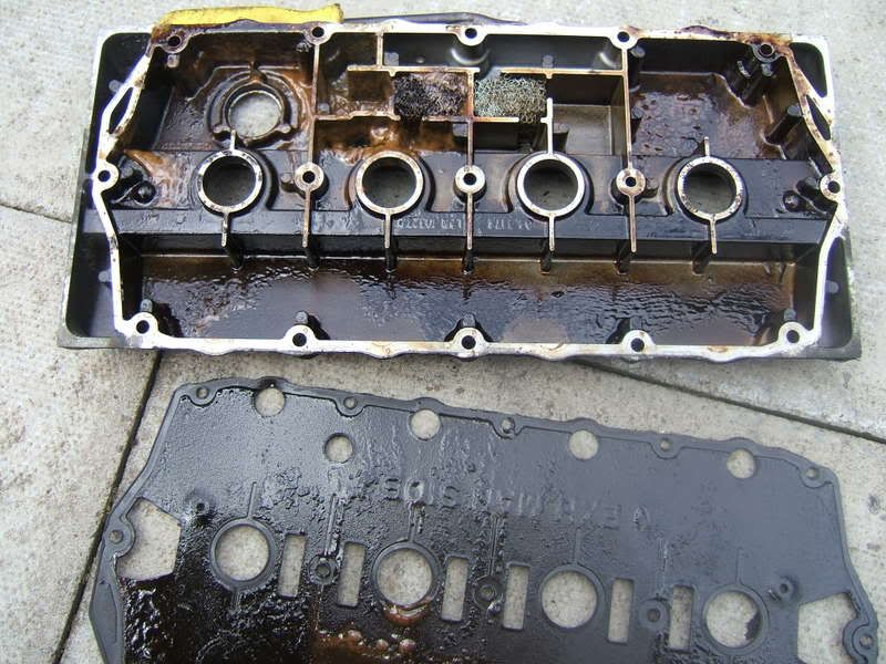

latest project....assumed head gasket failure....most of the symptoms displayed..
but now... im not 100% sure this is head gasket failure. Probably still is. Jamie / James etc and those of you that know or have done this job may be able to comment.
Tell tale symptoms that exist - mayo / gunk in coolant ( but its floating as opposed to being really thick gunk), some gunk under filler cap, no gunk or mayo on dipstick.....
Drove the car 15 miles ( very lesuirely drive and no idleing) no coolant loss and no overheating. Car drives fine....no performance or idle issues - although it wasnt thrashed, heaters and air con giving hot and ice cold.

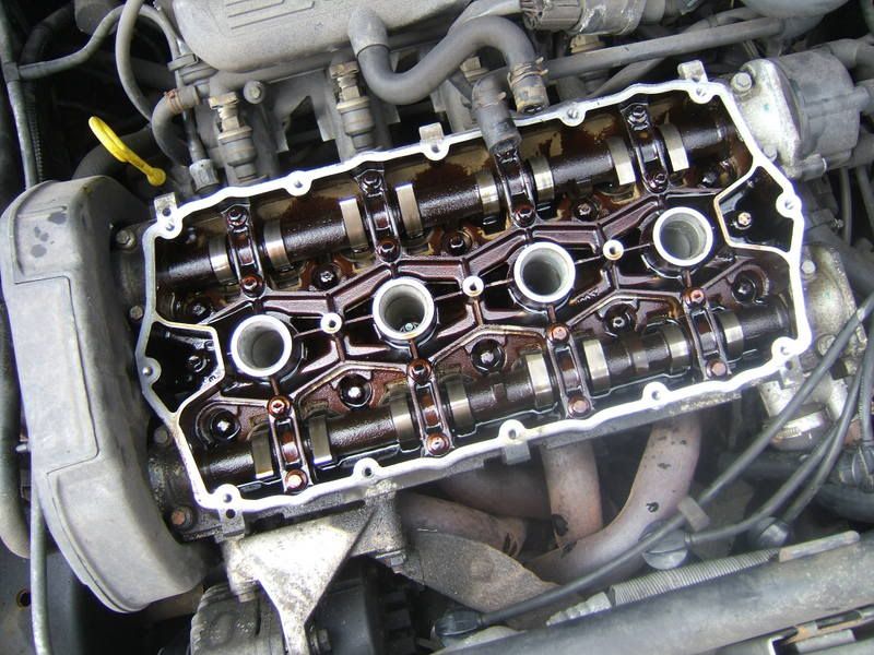

More significantly for me when i have removed the cam cover there is no gunk on the top of the engine / cams - just nice coloured used oil....i must stress - no gunk at all...i expected ( as i have done one of these before) to have a head full of mayo.....

the usual floating mayo - not as bad though as some head gasket failures....
intrestingly the mayo is only on one small area - thus giving impression of a bad build up ( conincidentally the oil filler cap is in this area)
finally - the norm here is a complete light brown / white lather....theres no mayo here ( this is what i saw as soon as cam cover was off....note the black used oil at bottom of picture along camshaft....

All I can say is, give it a coolant flush, oil change, and see if it comes back. Also compression test it...
Usually they're more spectacular than that, but it may just be in the early days..

Liners will be fine, if it's driving OK
Please do a compression test though.
If the mayo comes back, it will be HGF
Note - Castrol GTX causes a bit of mayo in these beasts.....

i think this is probably HGF to be honest, just taken top hose off and its very thick and mayo`d up.......still at an early stage perhaps....

I reckon it may be the first hint of HG...   ...there is (small amount) of water in oil, and (small amount) of oil in coolant.  No oil coolers, so has to be :(
yep, specially after i checked its gunked up plumbing....
