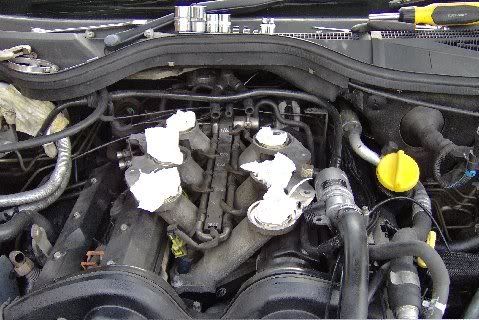

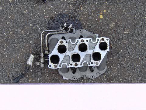

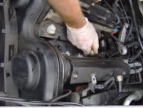

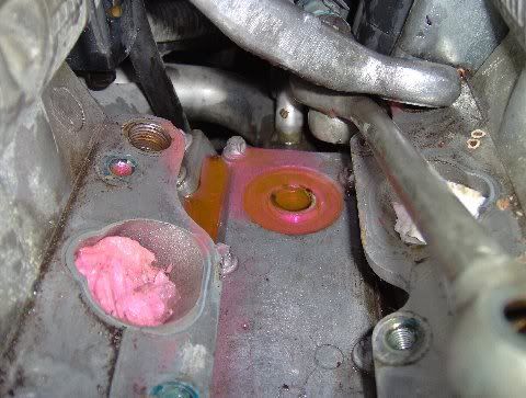

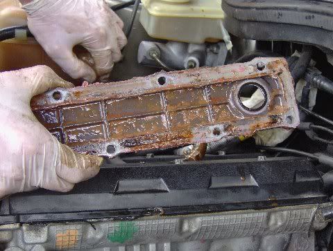

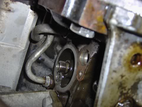

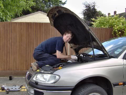

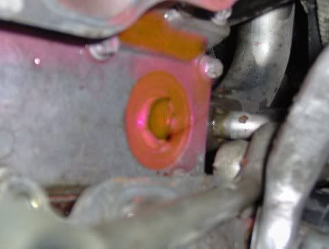

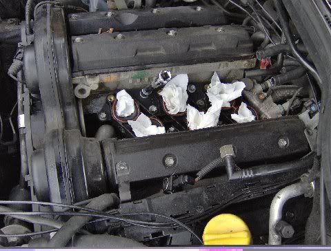

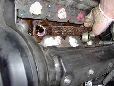

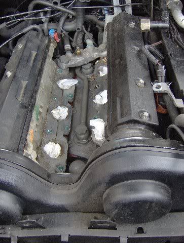

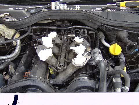

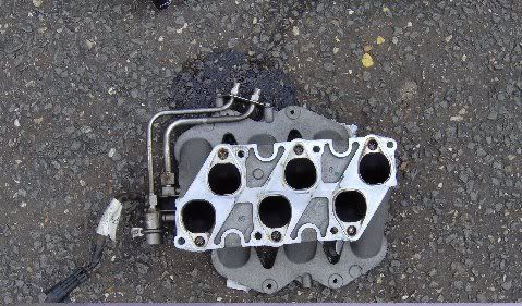

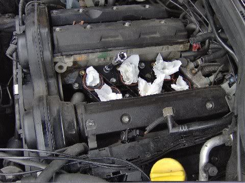

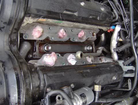

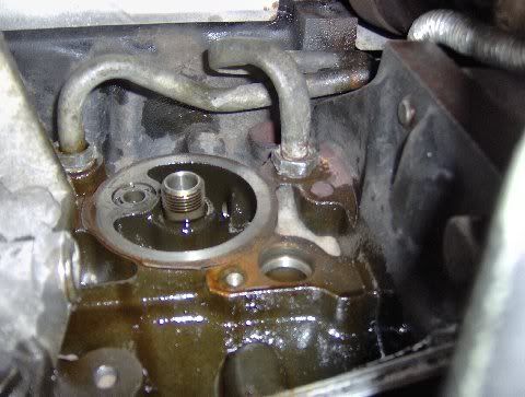

... went extremely smoothly. Couple of extremely minor setbacks, but nothing that couldn't be overcome. Finally had a chance to use my new crows feet. Great weather for it too.
I've just been sent the pics, so thought I may as well humiliate myself on here as usual ;D

The 19mm crows foot spanner realy does make this job so much easier to do, as a tip, if the block end of the pipes are stuck, tighten them slightly first.

I would not have like to attempt, without the crows foot!

If you do, it distorts the hex on the nut and then your in real trouble.

I did before i managed to track one down...a godsend!!

You really should feed that Meega more often Mark, in a couple of pics it looks like it's trying to have you for lunch! :o

There is no way that i would be smiling like that if i was left to do that job :-/ :-/
