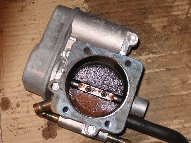

Ok, I've cleaned the breathers and throttle body some time ago and the idle speed has dropped from 1500 rpm to 700 rpm.
But it only does this when standing for a few seconds at standstill and often won't drop below 1000 rpm.
If I slip it into neutral whilst driving it stays nearer the 1000 mark.  I popped off the hose and lubed the butterfly with some 3 in 1 but it still doesn't seem smooth to me.
More carb cleaner, more 3 in 1, something else, or just leave it and hope it sorts itself?

Re-checked all the pipes and all secure, no splits, no hissing & all in the right place.  Idle does slow to normal 700 when engine hot but seems to pause at 1000/1100 before doing so - like a 2 step drop.
Should I tighten the torx bolts on the throttle body some more - currently tightened to stop + 1/4 turn?

Pics of throttle body before http://i123.photobucket.com/albums/o317/chopsdad/IMG_1082.jpg
and after http://i123.photobucket.com/albums/o317/chopsdad/IMG_1084.jpg
« Last Edit: 26 November 2006, 23:04:46 by Chopsdad »

That pipe blocked up is stopping your crankcase breather system from breathing!!
It will certainly not help your idle issues, clean it out thoroughly until it's squeaky clean, and also make sure the flametrap is ok.
I'm not happy about the colour of that gunge either, what's the general colour or your oil like, eg on the dipstick and under the filler cap, and are you loosing any coolant?

The pipe has been thoroughly cleaned with carb cleaner 2 wks ago and car feels better.  Oil changed 3m ago & dark already, so I'm going to do a couple of 1000 mile changes to flush it through.  Filler cap is clean as a whistle & no sign of water in there.  Not losing any coolant, but I do now do a lot of short runs since moving house and breathers never been cleaned before - 42k on clock.
