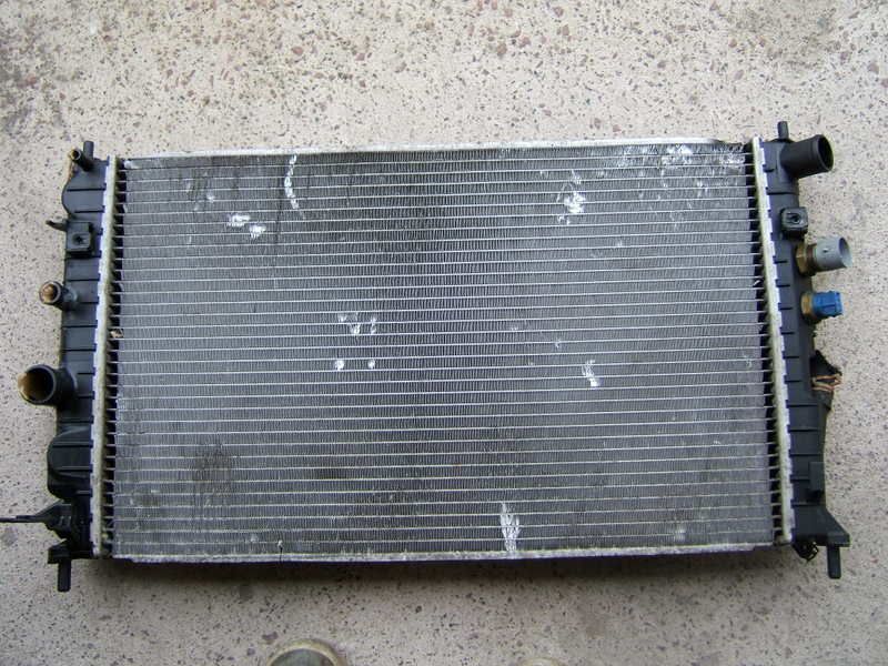

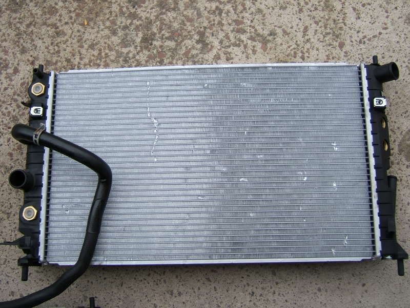

okay the pirtures.....
this is the old radiator
note the differences on left hand side of new radiator

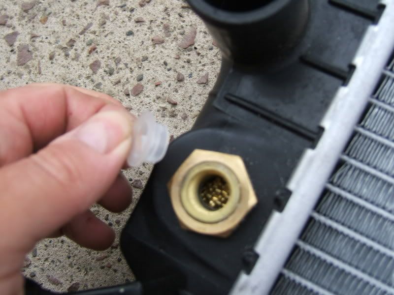

and a close up of the difference...plastic cover removed to reveal hole....

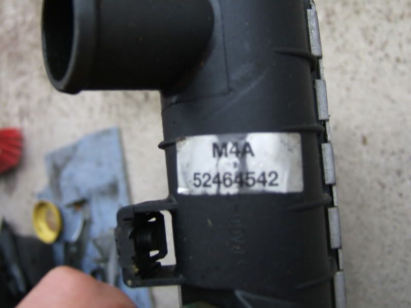

can anyone find part m4a 52494542 on epc ?
« Last Edit: 23 October 2007, 19:26:16 by Markiec »

old radiator again, anyone advise descrition of this part according to vx please?  :y
  • Posts: 107622
Re: Vectra Radiators  -  Urgent Help require
« Reply #10 on: 23 October 2007, 19:28:47 »
Markie - defo looks like atf oil cooler...
I guess that left side is also the 'cold' side of rad (bottom hose side)
« Last Edit: 23 October 2007, 19:29:48 by TheBoy »
« Reply #11 on: 23 October 2007, 19:29:10 »
Those are where the pipes from the auto gearbox connect, its the gearbox oil cooler :y
Markie
  • Lanarkshire, Scotland
  • Posts: 7762
    • RS4, BMW X5, Range Rover
« Reply #12 on: 23 October 2007, 19:31:05 »
so Pete / Jamie should be good to use and leave little blanking plates in ? no different part specified for manual or auto according to vx....
« Reply #13 on: 23 October 2007, 19:32:02 »
Should be OK :y

just worried that the little caps come off and make a mess, but then i guess it may be partitioned off inside,,,, :-/
cheers Pete  :)
