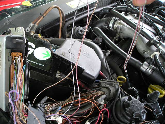

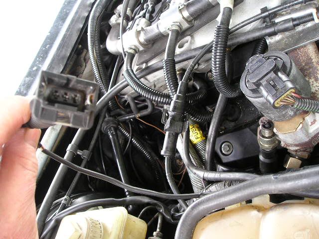

Eventually I decide to connect the new crank sensor directly to the engine ECU, as in the photo below. I adapted a crank sensor plug off a scrap Carlton, and wired it directly to the ECU pins 19 (earth) and 48 & 49 (grey/red, grey/black). The original wiring was left in place, other than disconnecting the original female plug. So any taps into it for the LPG etc are still there. My new wiring simply bypasses everything.
The battery is disconnected all this time of course, so the original fault code should have been cleared. Switch back on, knowing that crank sensor is now firmly connected to the ECU and guess what -still fault code 19! Still no spark!  (Go to next paragraph below)

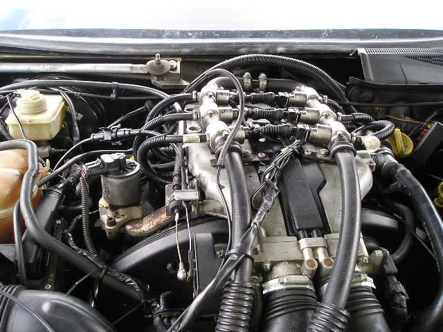

General view of the engine bay.

if your getting code 19 it wont go mate but a new genuine crank sensor from vx will help and the code will be stored for 20ish clean starts so even if you fit a brand new the code will still be there untill the car has been started and run at least 20 times ! :(
