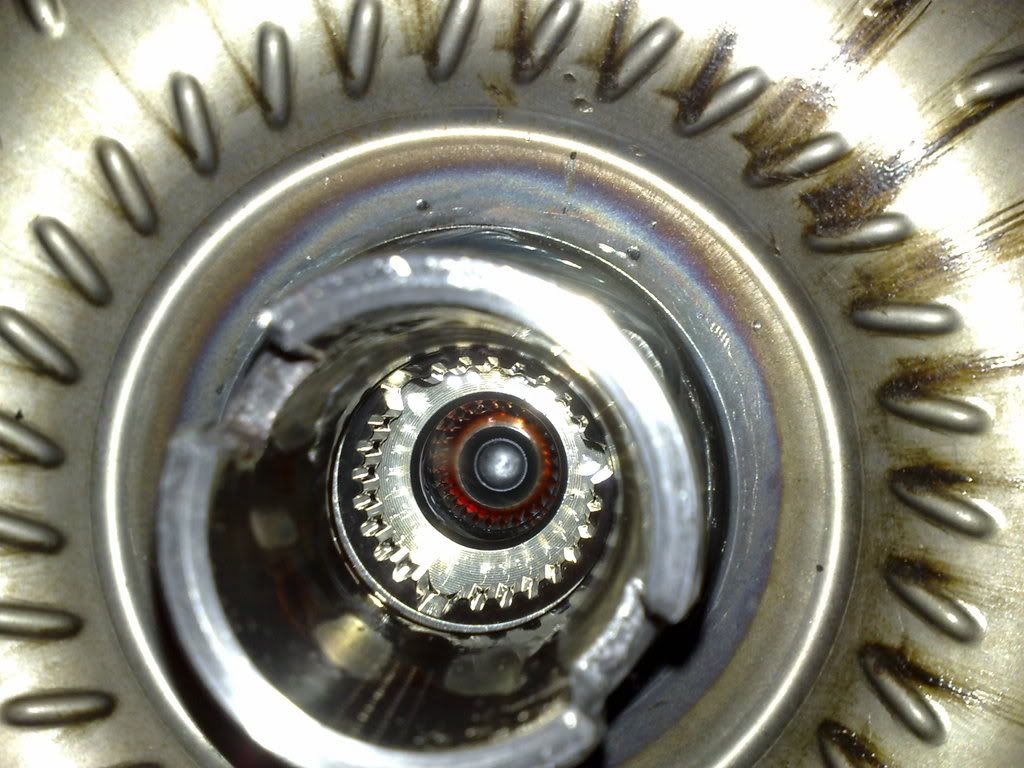

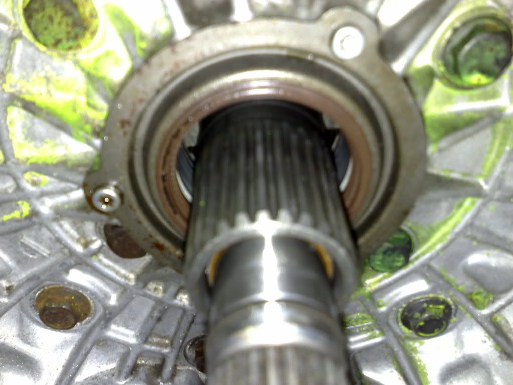

At long last began the job. Will add a series of pics later on the main progress. Biggest pain so far was access to some of the top bolts round the bellhousing but managed it, drew blood on only one finger too  ;D.
i have inclused three pics of my main are of concern prior to refit, the input shaft/ torque convertor seal. Is it worth replacing as a matter of course, or would a good clean up suffice. I only took these pics this morning, have not cleaned that area thoroughly just yet.

Weighed up the pro's & cons after speaking to Jeudu2. Will replace input shaft/pump seal. the cost £10 inc postage exceeds the pain it would be to strip it out again if there is a leak.
