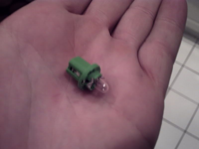

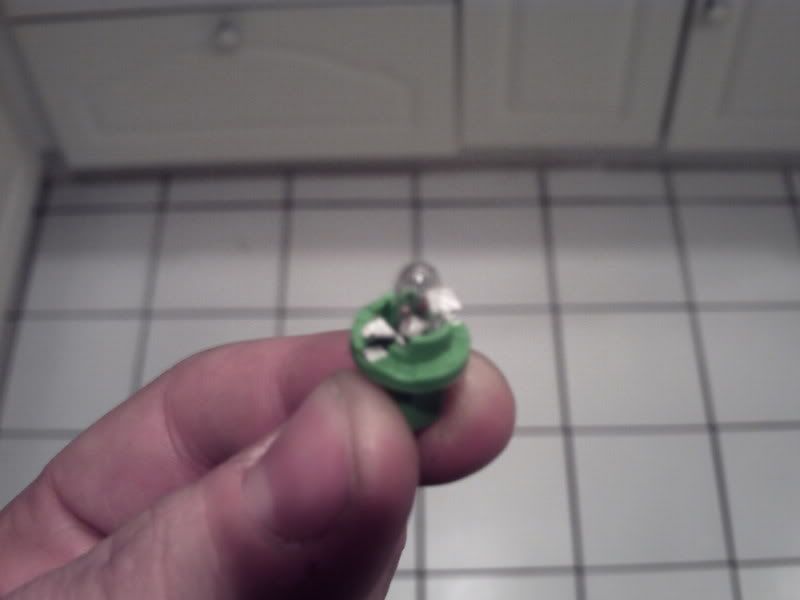

Anyway this is a pic of the ONE bulb he had.
Is this the right sort???  :-/

The one he gave me defo looks like the right ones then.

It certainly looks right, in the vec there were black holders and green ones but I think they were the same. I double checked with Mick who runs the site I linked though and he said its 5 x 509t's for the Omega climate control. I have also got the full switch kit for another fiver, (almost) does all the switches except the traction control. I am waiting til he is back at work on Monday to see if he does something for that. Last lot I had of him had full instructions and he included a phone number so he could talk you through if you got stuck.
