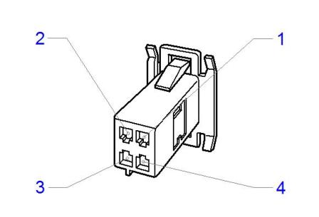

But I've noticed that the ciggie lighter doesn't work.  When I've took it out, there's only one wire going to the plug - a brown one with white trace.
When I've traced it back, there's another 2 wires which are soldered onto 2 smaller-guage wires - which I assume were destined to go to the ashtray unit connecting plug before the boys in blue decided they should go elsewhere.
The plug has slots for 4 wires - was one of the slots not used, seeing as I can only find 3 wires in total?
Also, which wires should be connected to which plug, as you look at the female connecting side from the dashboard?

according to my diagrams, on facelift:
Brown: 0V
Black: Ign 12v
Grey/Yellow: Illumination
But if plod have messed around, who knows....

if you are having to bodge it in, the 12v ign is feed from F14 on facelifts

Cheers bud - yep, they're the 3 wires I have.
Which wire goes where in the plug?
1 - f14
2 - dash illumination
3 - 0v

Thanks once again TB - all wired up again and working.  Cheers  :y
