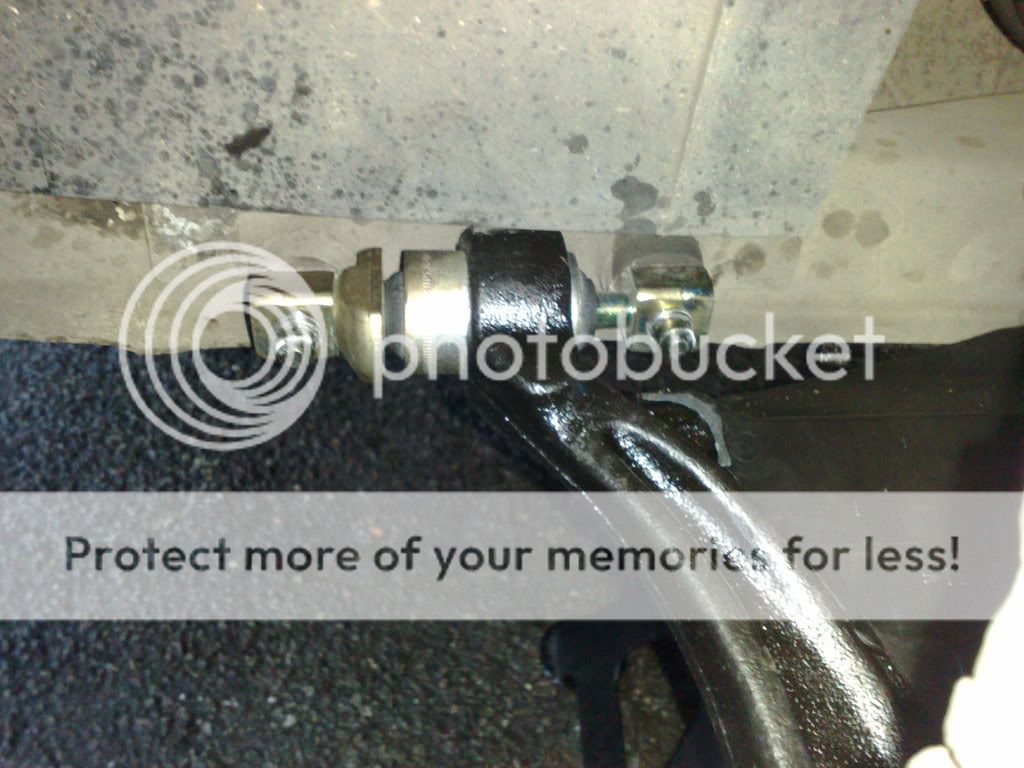

been harbouring this idea for a while, personally i don't like the way the omega bushes allow so much movement in the steering wheel,ie pulling/twisting the wheel in your hands, even with new heavy duty bushes pressed in to wishbones by Marks dtm fitted and torqued correctly, there is an improvement, but it still bothers me as its still there. So....
 Fitted these to a Volvo C70 t5 turbo yesterday, seems a far better way of going about it, not to mention easier to fit, jack up to jack down 55 mins. looking at it and driving the car tells me there is far less movement in the bushes.
 But the whole thing is a completely different design, obviously. So will either need a complete re work of the sub frame by removing the brackets and drilling through to weld in a spacer to take the 65nm torque, angle tighten 120 degrees and the forces from the wheel,
 not the best. Or far better, fitting of another sub frame that fits with this design of wish bone bracket already incorporated. Does such a thing exist in the GM range? maybe new shape vectra or signum, monaro/vxr maybe?
pics below.... :y
the old C70 wb, note square blocks to bolt through and smaller bushes
new one fitted, not so clear a pic.
a closer look at the bracket to sub frame, the studs showing through the square blocks are the ends of the bolts which bolt through from the engine side, this involved jacking the engine to give clearance but was easy as there's enough movement in the engine mounts when bolted up.
what do you think???   :-/

ride is not harsh but you get more info fed up through steering wheel & feels alot tighter than standard bushes
Don't get any vibrations , but left rear bush in arm as standard as i was told changing it would cause more vibration
No more rumbling or road noise over standard bushings
Copes with arm movement very well. The crush tube is not bonded to the inside of the bush & the bush does not rotate in its housing. As the bolt is tightened the crush tube is clamped & the bush articulates around the tube which has a ground finish, reducing wear rate
Took it to the WIM meet last year & mine & Paul's ( VX1 ) were the only 2 cars Tony could work on iirc
As to cost i bought the round polyurethane bar which comes in 300mm lengths, had it cut & machined to size & had the tubes made to size from stainless steel, so all in all i ended up with 5 bushes for around £200 & the steering is as good today as when i first fitted them
