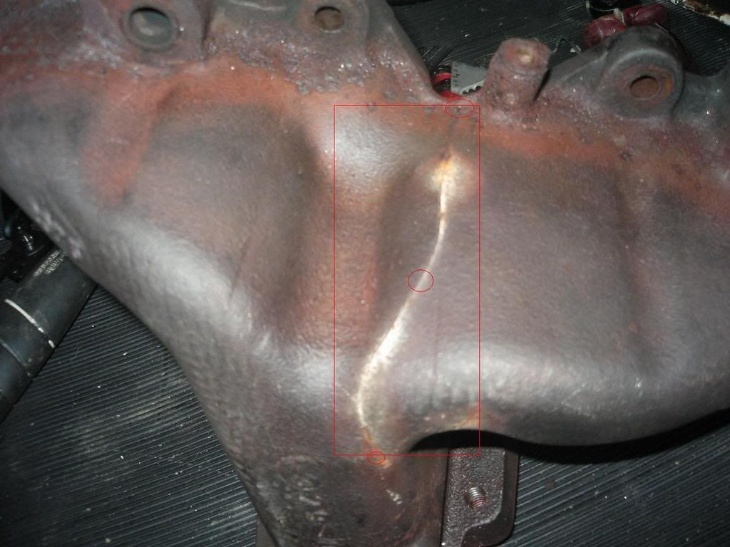

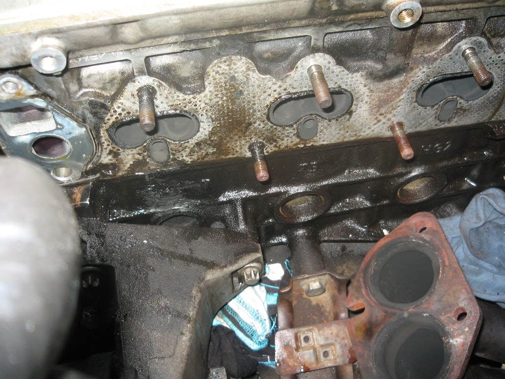

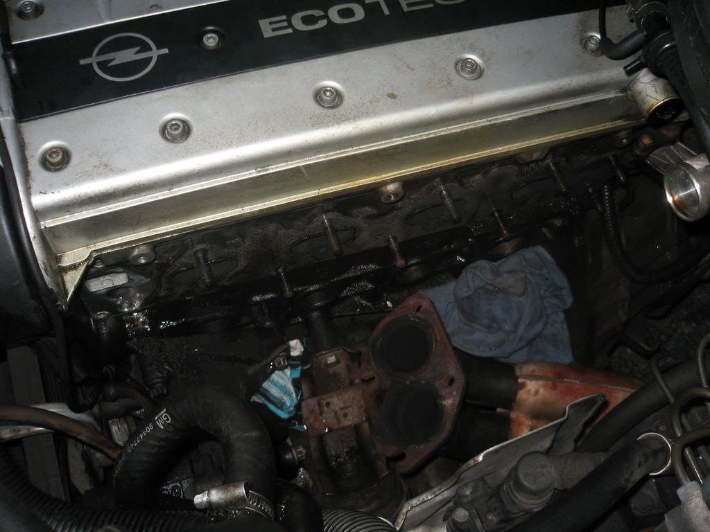

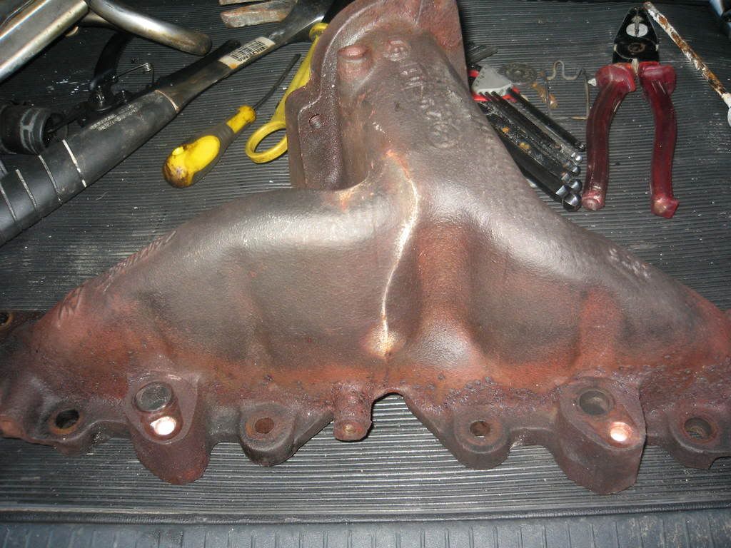

I have now removed the manifold.
The crack has acctually expanded A LOT the last 3 weeks!! :(
The thought was to bring to the workshop and first of alle remove the shreded bolt on the bottom flange towards the downpipe.
Then I was thinking of sand blast the whole thing to make it look better, but also to get a better view of the damage.
Now, for the repair.
I was thinking of drilling 3 holes. One on each end of the crack, and one on the center of the crack, tap it M6 and put in a bolt then cut it of flush with the surface.
The next step planned was to start welding at the ends.
weld 2 inches at each end.
The last step would be to weld the rest of the crack. Can i weld it all in one piece..?
Do you guys think this is gonna work ??

I wouldn't bother with the M6 holes, just get it all nice & hot before you weld it, and then make sure you get an nice even weld on/over the crack. In that position you don't need to prep either ie grind a V into the cracked bit.
A 'new' manifold would be easier though!  :y  :y  :y
No doubt, but a new car would be even MORE convenient..;)
Nothing but troubles with this piece of junk...
I was thinking of heating the material to approx 60degrees celsius, but is seems like others advice even more.. Perhaps I should go for 100degrees celsius...
You think I can weld it all in one piece or will this make the material drag against the welding point?
