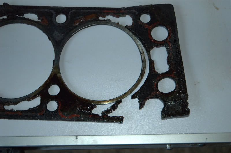

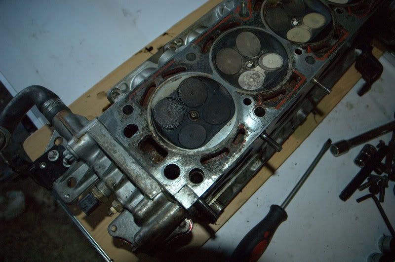

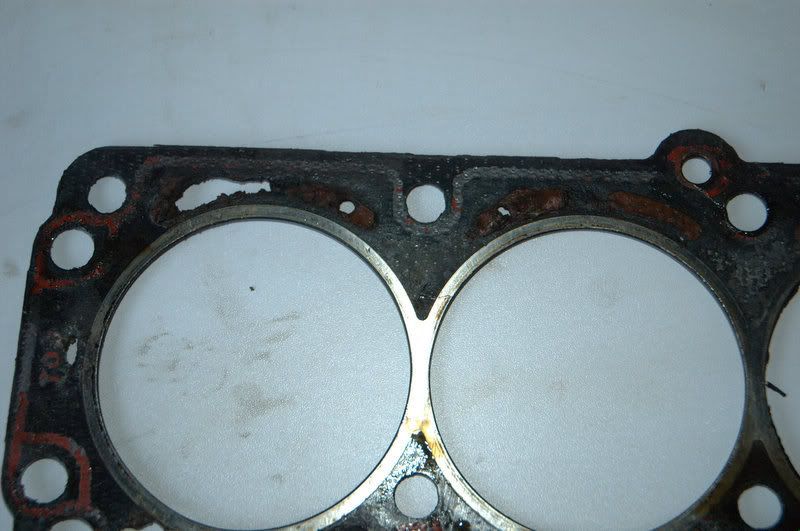

What is left of the gasket, and no we didn't do this getting it off.
Look at the blocked water channels in the gasket, thats good old radweld for you...

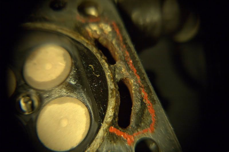

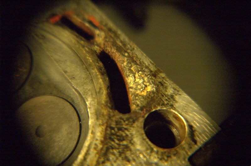

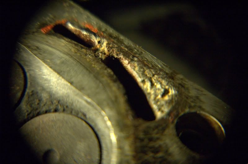

Its the corrosion around the water channels that are concerning me in the photo below
Can i get this head repaired, is there a repair compound that will fill in the corroded bits or do i have to get another head????

« Reply #1 on: 08 March 2009, 18:43:41 »
Can't see much damage as the picture is a little dull but a think it could do with a light skim
  • Posts: 34109
Re: Cylinder Head is Off
« Reply #2 on: 08 March 2009, 18:46:31 »
Get it skimmed by a few thou.......Most of that will go.
Should be fine.
What you can do, as a little bit of extra, is to wipe a smear of teh green goo used on the front cam bearings bits around the corroded bits to act as an extra 'filler'

« Reply #3 on: 08 March 2009, 18:48:24 »
not bad that light skim will look loads better seen worse gaskets as well  :y

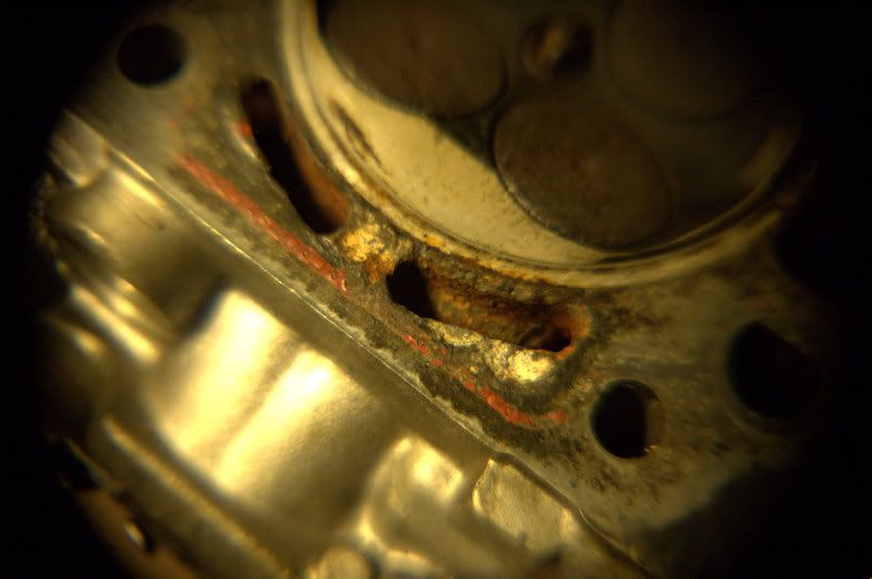

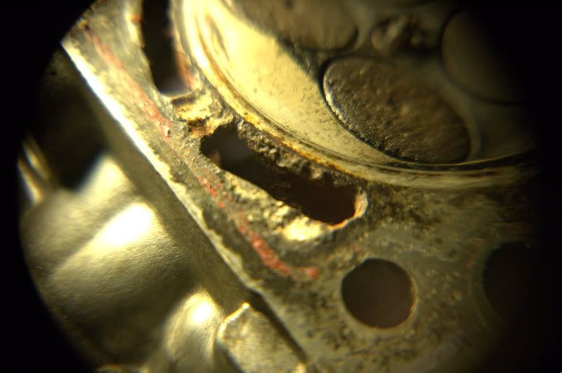

Close Up Shots...

« Reply #5 on: 08 March 2009, 19:20:15 »
Your not going to get a true idea of the condition of the head until you get all the remaining gasket off the surface and clean it down. Best way of removing it is with a small window scraper. Stanley do a good small yellow one that uses a flat blade. Just be carefull not to dig into the head. Asda smell them for 1.50. Then give it a wipe down with a bit of carb cleaner on a cloth. You will then be able to see the true condition

That gasket in the first photo was fitted by an aftermarket repair facility that do warranties less than 2 years ago...

« Reply #7 on: 08 March 2009, 19:34:02 »
Part of one of my old jobs was fleet manager and Ive seen far worse than that on a ali head. Take it to your nearest head specialist and ask there opinion, they wont turn you away if they think its repairable. Would be worth having the valves reground at the same time.

« Reply #8 on: 08 March 2009, 20:04:40 »
post these up as a warning to all 4 pot owners, make sure you flush coolant every 2 years, and never leave water in it.

« Reply #9 on: 08 March 2009, 21:35:44 »
...or use radweld!
Bets bet is to take it to a decent engine reconditioners - they'll soon tell you if it will live or not.  You'd be amazed at what a quick skim will do though.
I've used Wellseal many a time on marginal heads and not had a leak yet.

I'm okay for the admins to use these photos as a warning to people not to use radweld unless absolutely necessary and to use the recommended anti freeze.

« Reply #12 on: 09 March 2009, 15:05:32 »
you could always get it welded then reskimmed if the skim does not remove all the corrosion unit next door does quite a few head jobs like that
or as a bodge use hermatite red gasket sealer in the corroded bit just before putting it back together

« Reply #13 on: 09 March 2009, 15:51:47 »
so would that mean welding to fill the gaps then skimming to level it???
« Reply #14 on: 09 March 2009, 15:53:43 »
Yes but, you dont need to on this one.
None of the piting encroaches on the fire ring area (that I can see) or near any of the oil feed or returns or the edge of the head.
