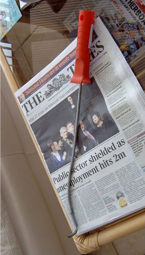

I made up this tool, using a paint roller handle, to release my Omega bonnet catch:
You need to insert it through the front grille, near the top, on the side nearest to the passenger headlight. The 'hook' at the end needs to be pointing upwards and it is used to pull the bonnet release-catch lever towards the passenger side of the car. Took me less than five minutes 'fiddling' to open my bonnet.

Agemo
  • Cleethorpes
  • Posts: 1545
  • Insignia
Re: A second call for help
« Reply #13 on: 02 April 2009, 19:56:56 »
Avionista, I have to say that is brilliant, I am obsessed by the fact that if my bonnet cable snapped, it could be very serious. I was going to rig a "spare emergency cable" even if it was a bit of string, just in case. Nice to know it can be opened with a home made Gizmo, I will have to make one.
