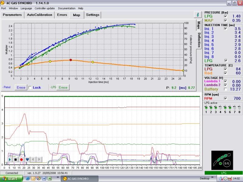

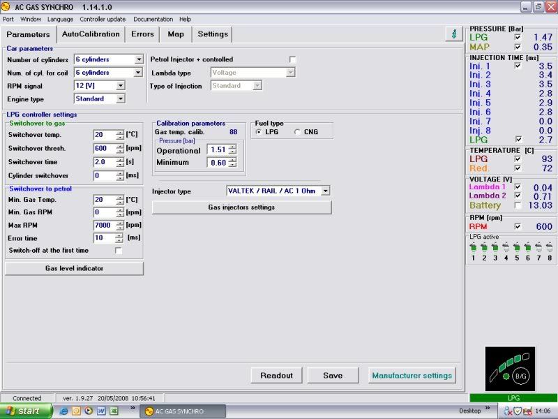

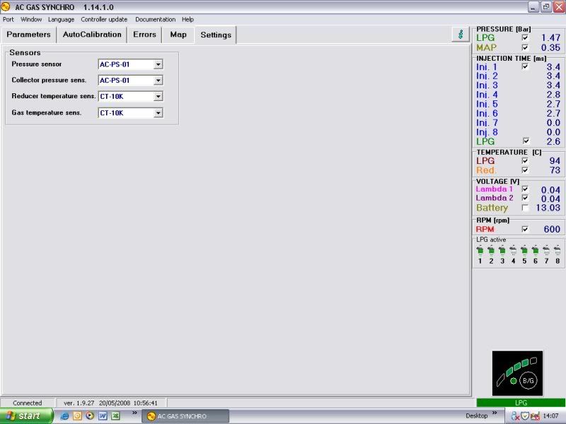

Had the LPG on the laptop today. Found out that the overly high rpm was down to the coil setting, which is now correct and reading true. This would also discount the crankshaft sensor as being the problem.
I switched off each injector in turn and found that with no.4 turned off it idles and runs perfectly.
Can I conclude that there is a leak at no.4 or that the injector is goosed?
I have posted some screenshots of the software whilst at idle. Maybe Kevin Wood may like to check them for me :y

Re: Strange LPG issue
« Reply #35 on: 09 April 2009, 14:57:40 »
Do I recall you mentioning a smell of gas?
Screen shots seem to be OK, although (and it's difficult to tell from a snapshot) it looks like your Lambda sensors may be playing up... I've got a lazy one and I think it's the heater which has packed up as it's fine at anything other than idle ::) ::)
  • Posts: 36497
« Reply #36 on: 09 April 2009, 15:26:54 »
Gas temperature looks a little high. Maybe the setting for that sensor is wrong? (there's certainly one that had to be changed from the default).
If you've got a smell of gas and a misfire on no.4 it might be worth taking the plenum off and making sure all is well with the pipe down to the nozzle. Failing that maybe the injector for that cylinder is blocked or in need of a clean. I would be inclined to speak to Jeremy / Teilo about that. Never taken one apart myself.
Lambda activity does look a little erratic but so was engine operation during that log. Does it settle down to a slow switching after idling for a while?

« Reply #37 on: 09 April 2009, 15:46:42 »
It completely settles if I switch off 4,5 and 6. 4 is the worst with 5 and 6 not tiptop. I think the whole bank needs a little attention tbh.
I have tried all settings for the sensors and this seems the only setup that works. Weather permitting Ill get the plenum and inlet off tomorrow and check all is well down there.
What are the consequences of running it with injector 4 switched off for the time being? I presume it uses petrol on just that 1 cylinder?
