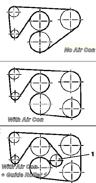

Same happened to me 2 weeks ago,As long as you didnt drive for long you should be fine,Mine as i was told on this site was the aux belt the spring loaded tensioner had gone(bearing siezed)just check all pullys they should all turn apart from the crank,Easy job as long as you have a diagram to help you with the long aux belt. :-*
Re: Help water pump and power steering gone
« Reply #7 on: 12 May 2009, 21:07:13 »
Aux belt fitting diagram - hope it helps :y
Yours is probably the middle one if you've got air con ;)

Thanks very much for the diagram and all your help have got the pump in now just have to fit it up to the pullys will check the tensioners the haynes manual was doing my head in
