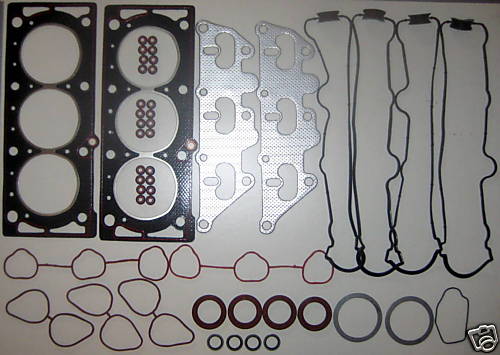

I need to have a look at one - I think mine may be the wrong way round

Re: Urgent photo of V6 head gasket needed
« Reply #6 on: 25 May 2009, 17:51:29 »
It does look like it's possible to put on 4r$e about face, but looking at the oil way, I think you'd have a huge oil leak from the head where the oil is supposed to be going up to the head.

The pattern one I used is wide the whole length
thats a 2.5 gasket set the 2.6 has metal layer gaskets  :o
but the oil hole in the gasket will still be relative to the oil feed.

also you carnt get them wrong way round  ::)
You can I did!
Little holes on the gasket were both at the same end of the engine :( >:( :'(
 :-/ I know it's now irrelevent now, but, using the gaskets above, which way were they wrong. Did you spin them along a north/south axis or an east/west axis? Either way your oil way wouldn't be lined up.
