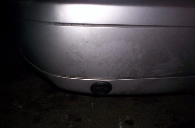

Then out came the tools. First job, was to find a good place in the bumper for the filler. I chose quite low down, drivers side, near the back. It was the only place I could get the pipework in behind it.
So, first job was to drill a big gaping hole in my bumper! A little daunting, but was easy enough.
Then I fitted the filler (swine) and plumbed it into the tank.
After that, went along to BP, for the first attempt at filling with LPG. Connected up the gun, so far so good. Pressed in the button... and...... ahhhhhhh....  a lovely sound, she started filling with gas.
at 44p/litre, The tank took just under 68 litres, which cost me £30  ;D  8-)

Filler: (Excuse dirty bumper)

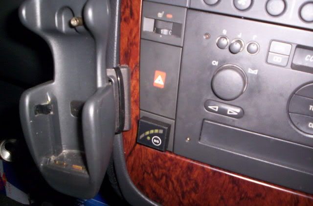

Cabin switch:

Fitting the switch is alway a worrying job, but then you don't take the kit back out

Oh, only one more thing, I need to adjust settings for the sender, because it was showing 3 lights when it ran out. But that's a 5 min job :y
The led fuel gauges are pretty crap tbh James......but three leds on is a bit too far out.
Mine usually does put the red led on before running out.....
Tho how i measure distance left is, i use the trip milometer......i know i can go 125miles about town or 200 on a motorway run.....  :y
Is that all? How big's the tank Dave?
