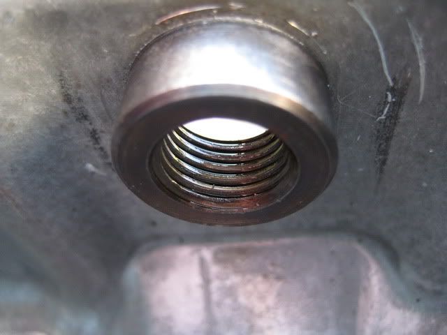

These pics, from another site, show a large nut, mine is a small cylinder ?
http://www.vauxhallownersnetwork.co.uk/showthread.php?t=62232Pics]
I can imagine there would have been variations during manufacture so either a plug or a cylinder fitment would have worked well

With the help of the gas hob, and some heat application, I got the old level plug out....Heat, then molegrips & socket.
This collar goes all the way through the filler hole, which it rotates in.
Is this fixable?

Well removing the front section I suspect will remove support for the input shaft....
And yes, reacon I can braise or weld that
