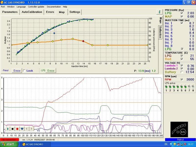

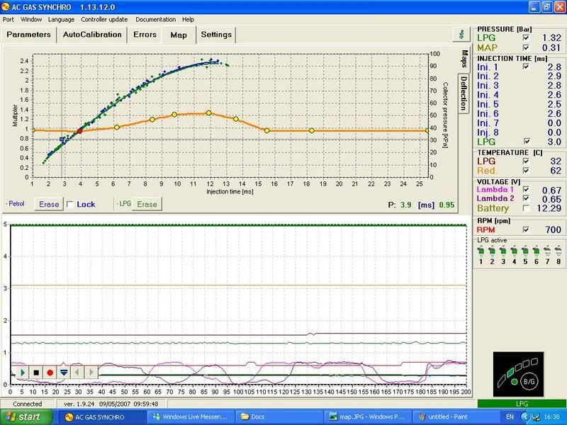

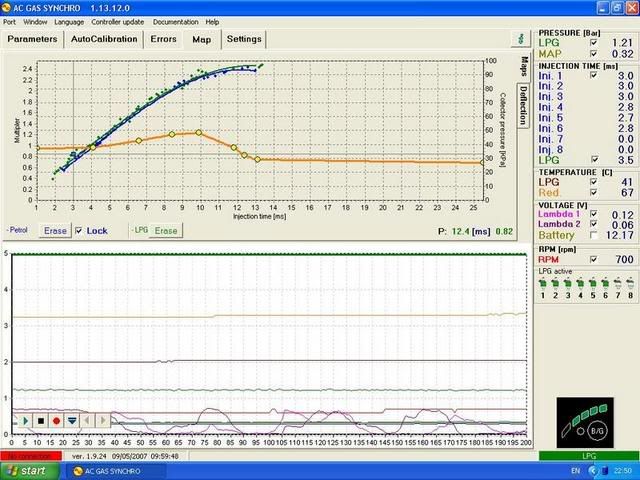

I'm still trying to get the mapping right.
I'm having the problem that I can spend a few hours getting the lines on top of each other... but next day I'll watch the graphs again, and it will appear a mile off
These are the best maps I have come up with so far:
The last one looks like the best...I did this one this morning. It pulls by far the best using this map, with no missing at all, and deflection is less than 5%. But strangely, it is now stalling on gas when going back to idle from any speed.
Not sure if it's related to the map, because today is the coldest day I've driven it on since the conversion...
I'd appreciate any thoughts, I'm getting mildly fed up now, I want to stop tweaking and enjoying driving!

If anyone has any ideas as to why it may be stalling using the last map, or any tweaks I could make to it, I'd appreciate very much.
I just wonder, if it's a case of the ECU needing to "learn" following the changes.
Obviously, caning the car and looking at the laptop is not a good idea (and probs not legal) - but I can see the lambda voltage at about 0.7 when giving some welly....
