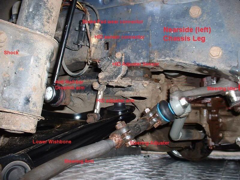

Andy H
  • Auckland
  • Posts: 5533
    • Mazda MPV
Re: Shudder on front on end
« Reply #12 on: 20 January 2010, 10:53:55 »
Also, where are the crossmember mounting bolts located?
In this picture you can see the end of the crossmember. The crossmember mounting bolts go through the chassis rail and the the crossmember (2 each side of car). You can see the holes to access the bolts (but not the bolts themselves) in this photo.
