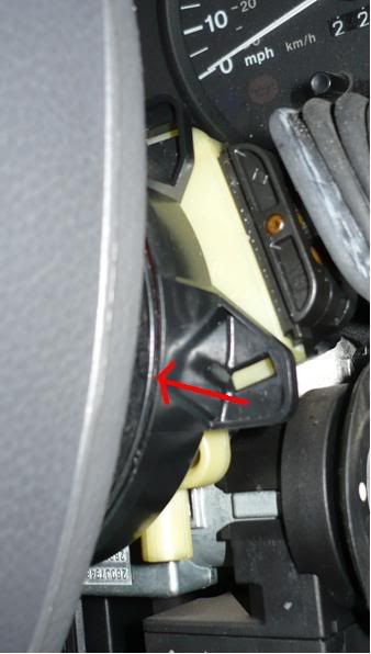

Driving the car tonight I was getting a cracking noise on turning the sterring wheel - like cheap plastic snapping.  Took a sharp turn and the wheel jammed and I had to force it (with more cracking noises) to get it to turn.  It now intermittently cracks and gets stuck when turning, it frees itself under force.
Took the cowling off & this is what I see:
There is a rotaing disc behind the wheel which rotates with the wheel.  The black plastic housing stays put.  Something behind the disc is getting stuck as I can see the disc flex under stress before it 'cracks'.  It looks like the steering wheel has to come off to fix it (how??).
Any ideas?

Thats the spinning section of the steering wheel loom. Be very careful if messing with it as the airbag is connected through it. You have to take the wheel off to get to it so disconnect your battery for at least half an hour before you start ;)

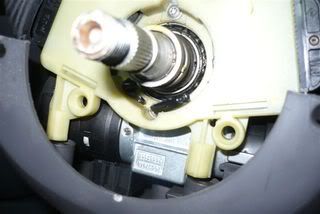

Right - all done.  The wheel came off with a few side-to-side wiggles along with a few taps around the centre spindle.  Then off with the spinner and this is what I found:
Note bits of plastic around centre spindle bearing
coming from here - the indicator reset mechanism!
So cleaned it out, smoothed off what was left of the mechanism (still sufficient there for the reset to work, at least for the time being) and put everything back.
It was a bit bloody dangerous though!  I had the kids in the car and luckily was going slow in a car park so could stop quickly but the whole steering locked up!
Thanks everyone for their help! :y
