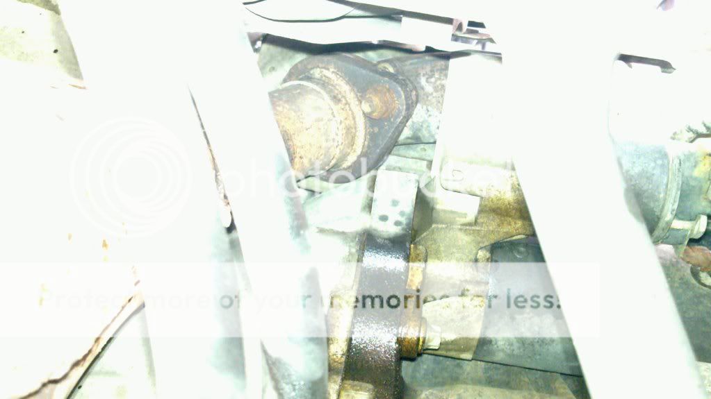

Re: Mat 3200 s omega, rear crank seal? pics added
« Reply #4 on: 21 April 2010, 22:52:28 »
starter motor top right no oil above
crank sensor side, no oil above pink may be from known previos hbv failure
bit of squidged cam cover gaskit sealent, its All round the covers
oil sensor, pressure? leak seems to come from it and blow back, no oil abnove
