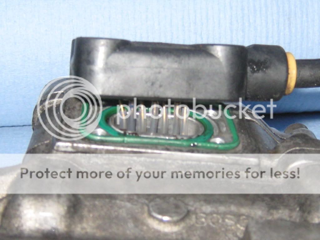

« Reply #13 on: 30 May 2010, 13:17:03 »
heres a couple of photos of what it looks like behind tne cover remember DON'T pull the wire any further than shown.
you can see the green O ring this is whats leaking on yours

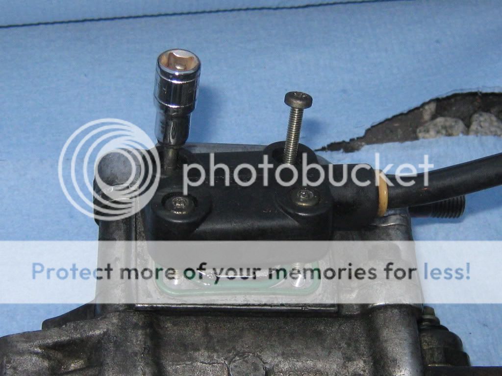

this next photo shows hoe to get the bolts out you need to gently chap on a 6mm socket to get the security bolt out.
