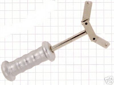

Confirmed that yopu have tried clever application of levers, clever clouts with a lump hammer etc?  I know there is a slide hammer type affair that hooks into the locating pin holes that may allow the pad to be released but, that said, i find its better to ensure the pad/piston is levered back at least a wee bit, before trying that.

  I know there is a slide hammer type affair that hooks into the locating pin holes  ....
 ;) :y :y
 ;) :y :y
cheers Andy.  never had to use one yet, always managed to lever and 'persuade' recalcitrant pads to break free eventually....  ;)
Niether have I ..... I've done the same as you. But I have seen a slide hammer extractor.  :y

Buy the slide hammer affair that Andy B wrote about - thanks for that :y
