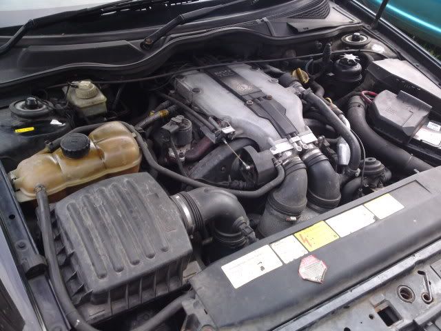

Anyway,this is her,just as i bought her so forgive me she's not looking her best
And the dreaded engine bay,been around ALOT of cars but this looks a nightmare
Thats all for now,will put up more as i get time
