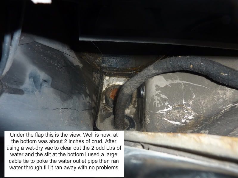

Check the opening in the wiper skuttle (just under the windscreen on the passenger side) for a puddle of water. there is a HowTo in the maintenance guide index for cleaning the drain under the pollen filter :y

i have some good pics of this if you need them  :y
yes please, that would be great :)

I hope this helps but it might not be the reason your car is icing up on the inside but its worth a look as it can stop other problems later on like wet carpets  :y

have had a look and the scuttle is clear, in fact at the bottom is a large hole where i assume there should be some form of rubber grommet with a tube attached to direct the water away. I could also see straight into the fan housing which looked dry, but should there be a pollen filter (seems like two grooves which soemthing would slide into. should there then be a lid or cover?
