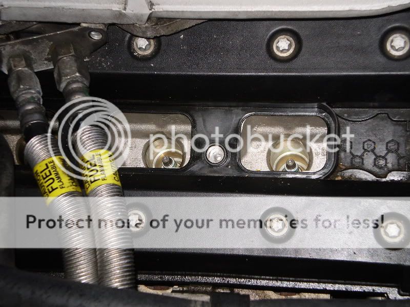

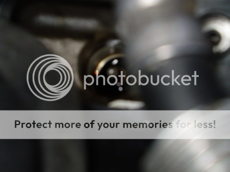

Further to my "rough running thread"using the pedal trick I got codes....0...3...0..0...and 0.....3...0..5
Using the OOF guide I have removed the coil pack from cylinders 1..3 and 5....only to find that plughole 5 is full of oil......Any ideas please.. :y....piccies to follow

« Reply #1 on: 02 December 2010, 15:40:17 »
cam cover seal,thats about the only place it can come from

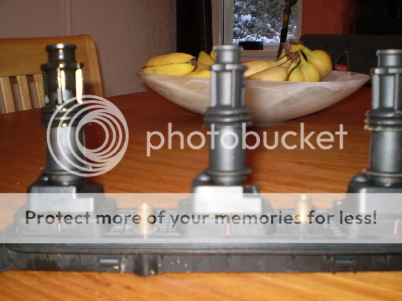

my missus would go bloody ape if I dropped an oily coil pack on the dining table :D ;D

« Reply #5 on: 02 December 2010, 18:51:31 »
Coil pack looks ok going by that very poor pic, provided the rubber boot is ok and not softened by the oil. They can split easy then it's fubar.

« Reply #8 on: 02 December 2010, 19:31:52 »
Number 6 banana is showing signs of spark tracking Opti, that's a definate pointer to your troubles! ;D ;)
