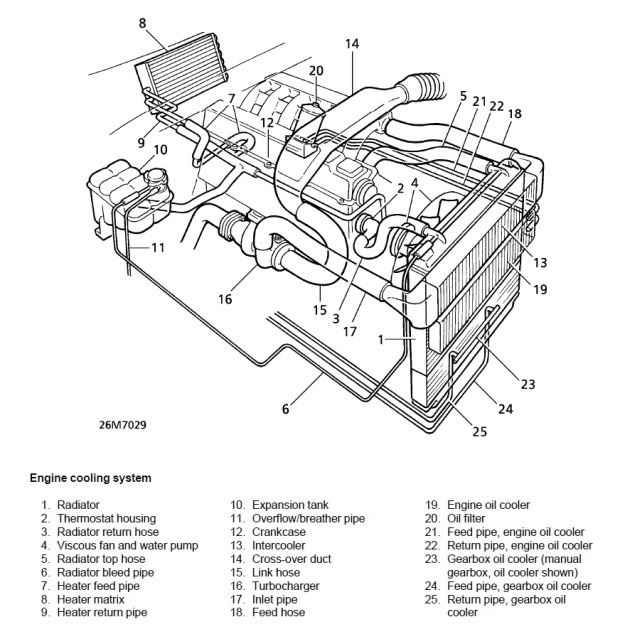

Cheers,but welung666 says follow large TOP hose and Theboy says follow the BOTTOM hose,which is it?any piccies to make it clear,anyone?
Welung666
Re: 2.5 tdi thermostat where is it?now confused!!!
« Reply #4 on: 20 November 2010, 19:30:59 »
We aim to confuse :y ;D ;D ;D
My error, sorry  :-[ I was working from memory so I've checked. The housing is mounted on the front of the engine behind and just above the fan, so that would be the bottom hose :y
Welung666
« Reply #5 on: 20 November 2010, 19:36:39 »
Number 2 is the thermostat housing. Ignore the radiator layout as it's a range rover one :y
