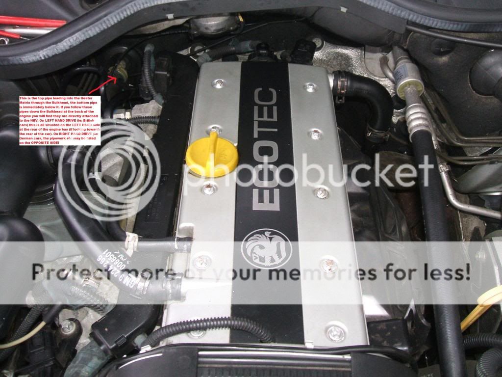

Take a look at the pic below.  It's the chunk bolted to the rear of your engine's head, which has the coolant outlet (far right of pic) which will be going either to your HBV, or direct to the matrix inlet if you have no HBV.  Note that your 'chunk' won't have a DIS bolted to the top of it, and the EGR will look different on your 2.2 versus the 2.0 set-up pictured.
If there's a single hose going from that coolant outlet to the matrix and nowhere else, then your HBV has been removed, relocated, or never fitted.  I thought all 2.2s had aircon (and therefore an HBV), but maybe not?

Have a look at these Pics Griff. You may need to zoom in on the text to read it though! Hope they help  :y
This is the HBV:-
This is the 2.2 Engine Bay:-
With apologies to Abiton, here is the 2.2 lump you will have on your car:-
