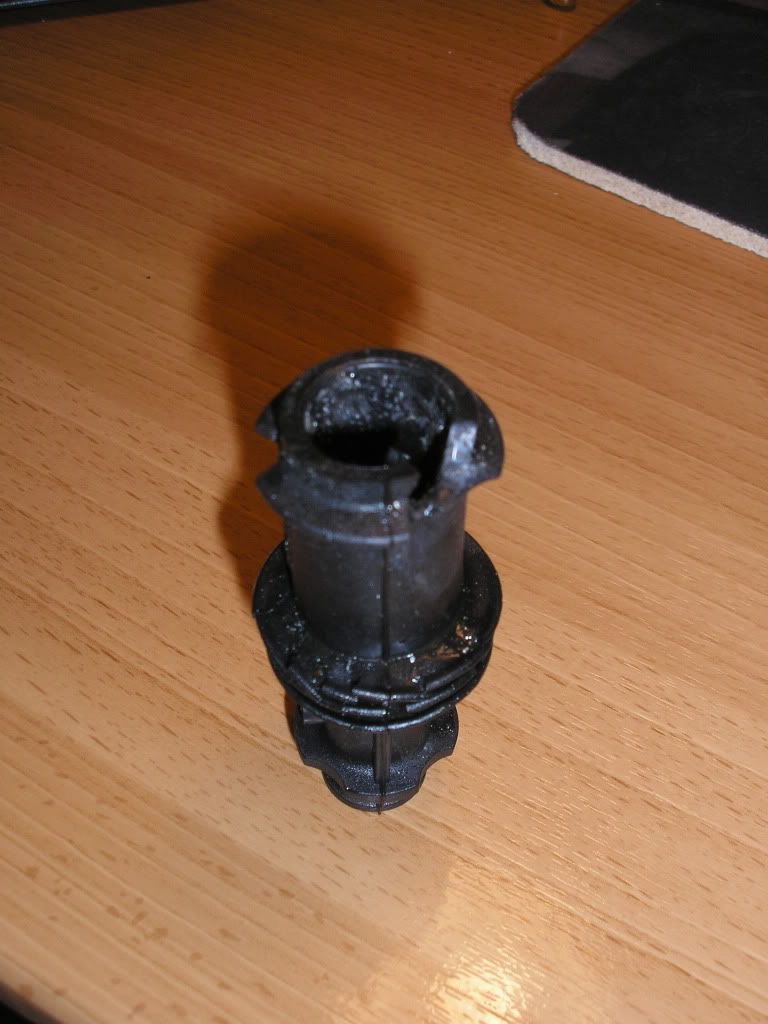

« Reply #5 on: 22 December 2010, 14:38:34 »
Thanks for the advice chaps. Much appriciated  :y
I've got the offending item off. However, it does seem to be a little damaged. May I ask, in your opinions, is this too damaged to put back on? Only the top appears distorted, and a small section (about 25%) of the very upper of the three lips, (which I assume act as grips against the cylinder head wall?).

« Reply #6 on: 22 December 2010, 15:46:58 »
I'd say that is pretty well knackered...

« Reply #7 on: 22 December 2010, 16:28:57 »
Goosed! Nick a spare from the scrappy or get another made up at local factors, would only be a few quid
These are the boots off the 2.6/3/2 Dispacks (One per bank and sit in centre over the plugs), unfortunately not the same as spark plug boots on leads.  :y

« Reply #9 on: 22 December 2010, 18:47:03 »
I believe the boots are available as spares from a stealer? or you could ask one of the breakers on here if they have one lying around? :y
