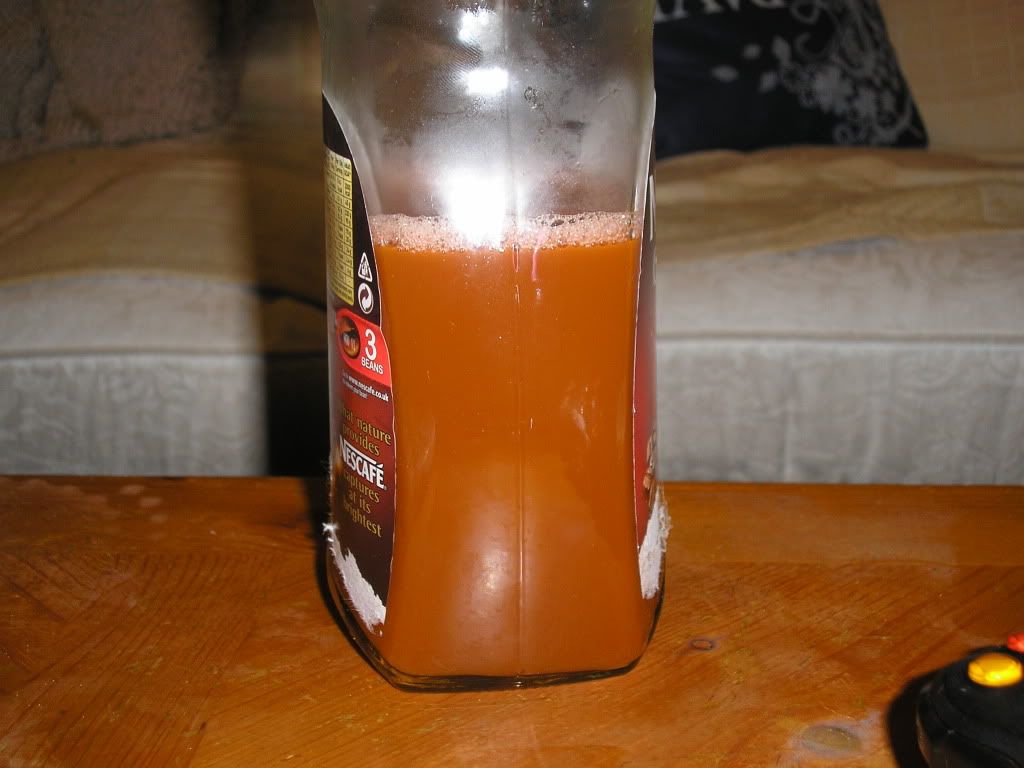

Oil drained, oil filter off, and here's a sample of some collant that I've just drained from the rad.
This time yesterday this was bright pink, mixed 50/50 with water. Since then the car has covered maybe 100 metres
The coolant was drained directly into the coffee jar, and the coffee jar was clean and dry prior to drainage.
What do you think?

.... and here's a sample of some collant that I've just drained from the rad. .....
yuk!  :-? :-? ;)

i've seen a lot worse, seen coolant look like hot chocolate!

And that's pretty dam dirty  :o
Having an old Landie that I use for off-roading, I'm pretty used to coolant systems being minging and filthy, but on the Omega it really is something else.
As I'm running short of time getting it back on the road I've just topped it up with fresh coolant which will have to do for the next couple of weeks, but TBH I don't think that flushing the rad, header tank and heater matrix is going to shift much of the grime.
So, a couple of questions. On Omegas with air-con, oil coolers and god knows what else plumbed into the rad, does everything need to be dissconnected before flushing the rad, or just the top and bottom hose?
Also are there any decent cleaning agents that can be used to shift some of this gunk, or are they all snake oils?
Many thanks  :y

once you've fixed the cooler, run the engine with a low suds biological washing powder in it .... mix the solution in a bucket first !!  Numerous applications eventually cleaned the one I did for a mate ... we were doing it 3 times a night for a week..... run it up to temp with the heater on max chat, leave for 5 minutes, switch off and allow to settle for an hour, drain, repeat.
What do you think?
Well, Entwood has had oil cooler failure, and seems to agree.
Was expecting more lumpy oil deposits and signs of Mayo. That just looks dirty to me. Any oil settled on the surface?
When the coolant was changed how much came out/went back in? Could there have been some old coolant in the system to contaminate the new stuff and give that colour?

If that coolant has a pretty thin consistency, I am not convinced the oil cooler was the cause of that!
Oil cooler will cause sludge - not discolouration on it's own.
I'd have been inclined to do lots of flushing and then monitor, before condemning the cooler, in the abscence of sludge.
