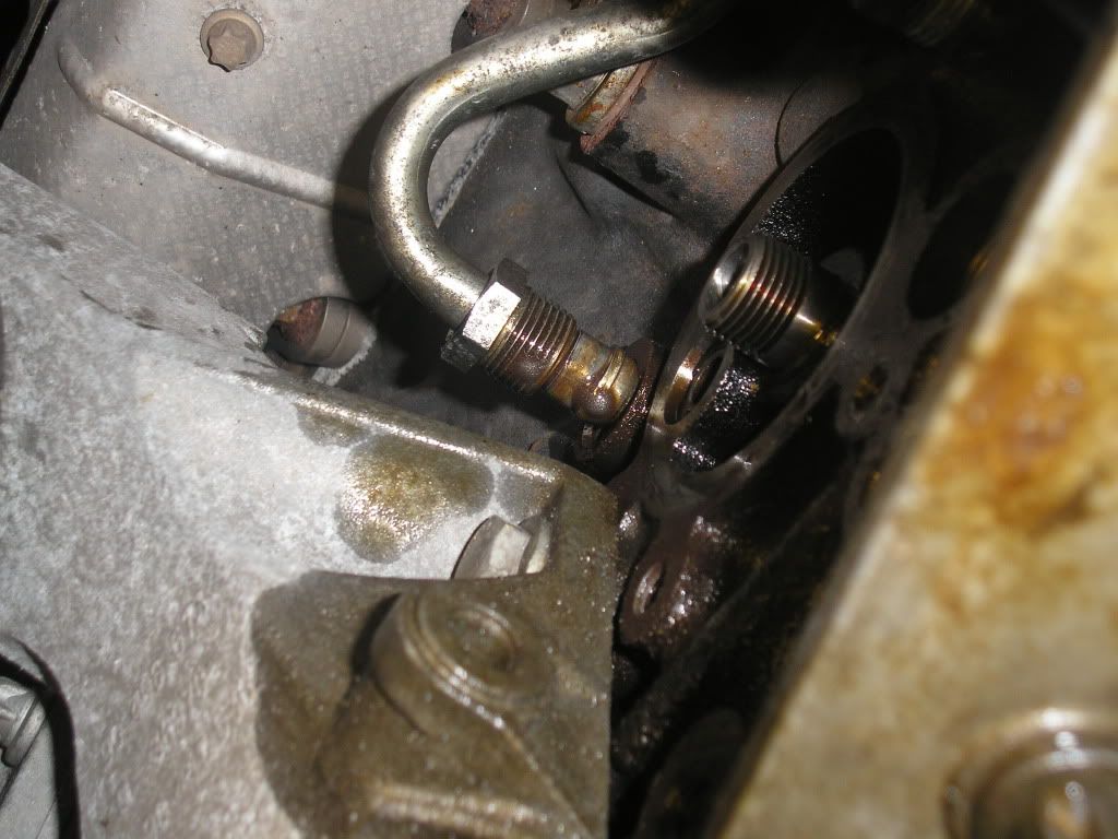

And now I'm stuck  :(
The union came off easy enough. Suprisingly easily actually, so I don't think that I have sprained the thread, but even after several hours of trying, I cant get the dam thing to screw back in again.  :-?
Anyone got any tips, (besides leave such jobs to the pro's).
Cheers  :y
Cheers  :y
and you can't slacken the other end? I know it's stating the obvious but you just have to get the pipe as central as you can ............

« Reply #38 on: 16 February 2011, 12:04:45 »
Cheers  :y
Thanks Andy.
The top is end slack, only on a couple of threads, just so that it 'bites'.
It's not going on at an angle at the bottom end, in fact it's about as straight as you could wish, but for some reason the flare nut just isn't biting into the thread, kinda the exact same problem that I had with the flare nut into my brake caliper.
With the flare nut on the brake caliper it must have been torqued up to about 2 million lb/ft. This flare nut on the oil filter housing felt to only be 20-30 lb/ft, maybe even a little less, so I cant see how the thread could have strained or stretched or got damaged.
The other flare nut attatched really easily, This one wont attatch at all.  :(

« Reply #39 on: 16 February 2011, 12:13:14 »
....The other flare nut attatched really easily, This one wont attatch at all.  :(
How about connecting this end first  :-/

« Reply #40 on: 16 February 2011, 12:21:34 »
Ah.....   :-[
To my shame I hadn't actually thought of that. In my defence it was nearly 4am when I called defeat last night.

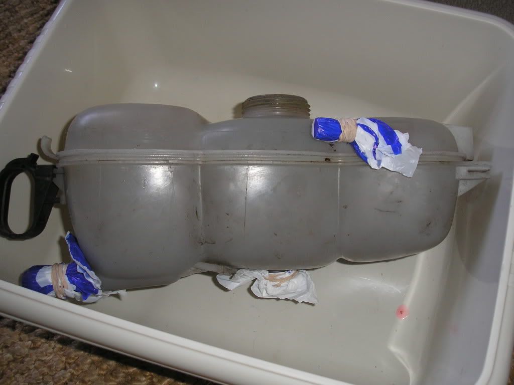

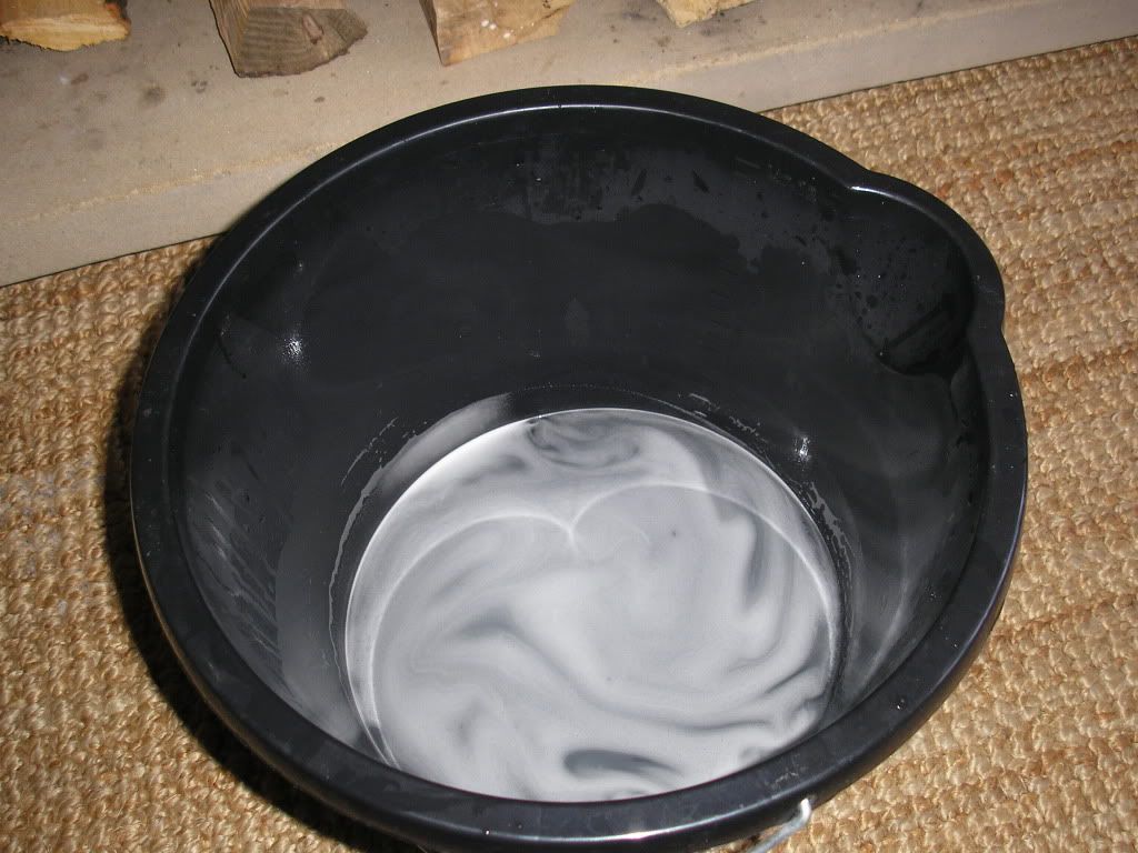

Well, it's done now. well, almost done, just need to finish off re-assembly.
Also taken my header tank off to give it a dam good clean out.
I put a splash of Persil in a bucket of boiling water to wash the header tank in.

Also taken my header tank off to give it a dam good clean out. ....
I uysed a bit of industrial strength caustic to clean mine out, which helped, but if I was you I'd get the system cleaned out & just replace the header tank with a nice shiney new one. IIRC they're around £35  :y
