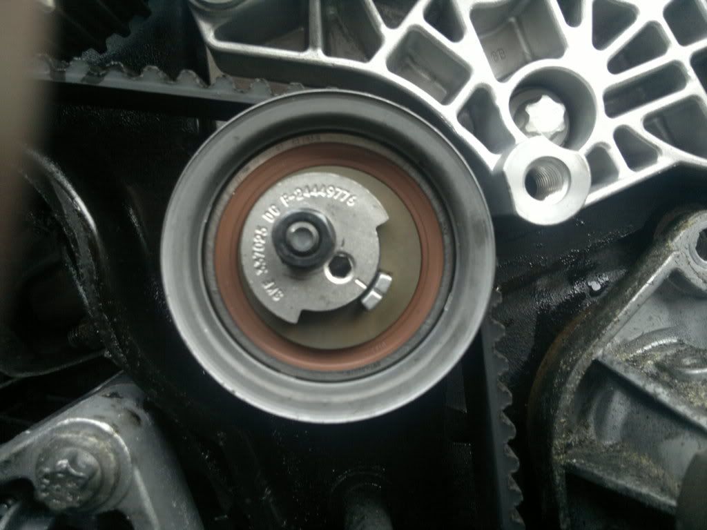

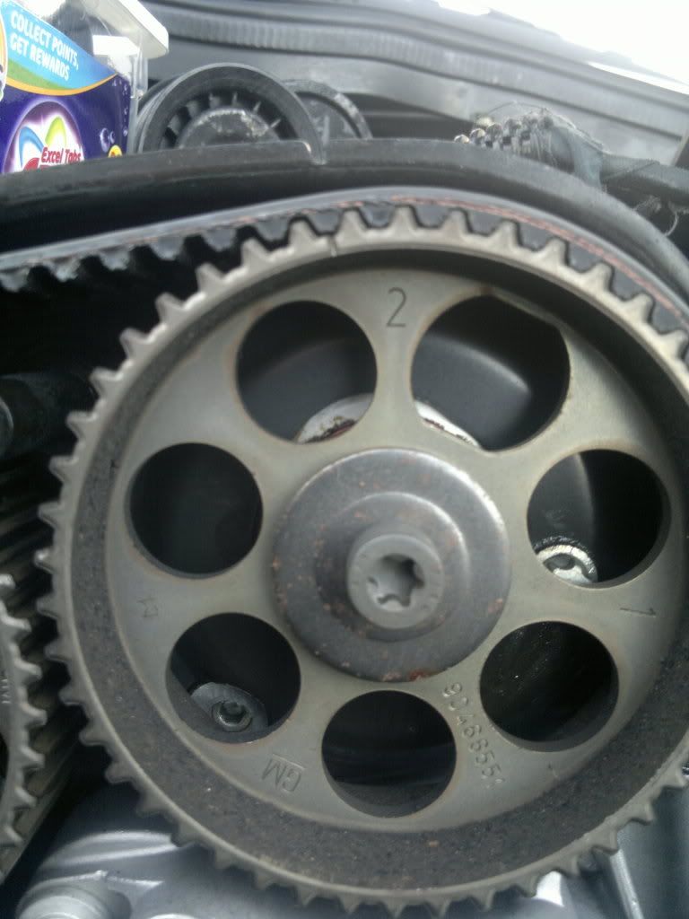

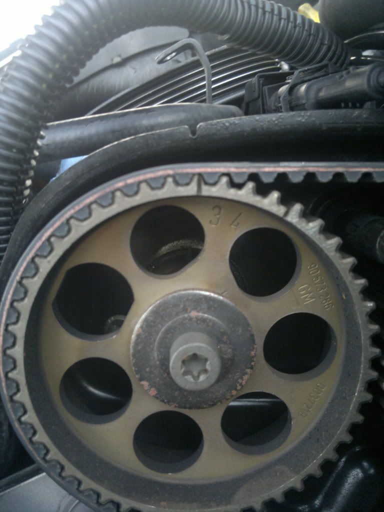

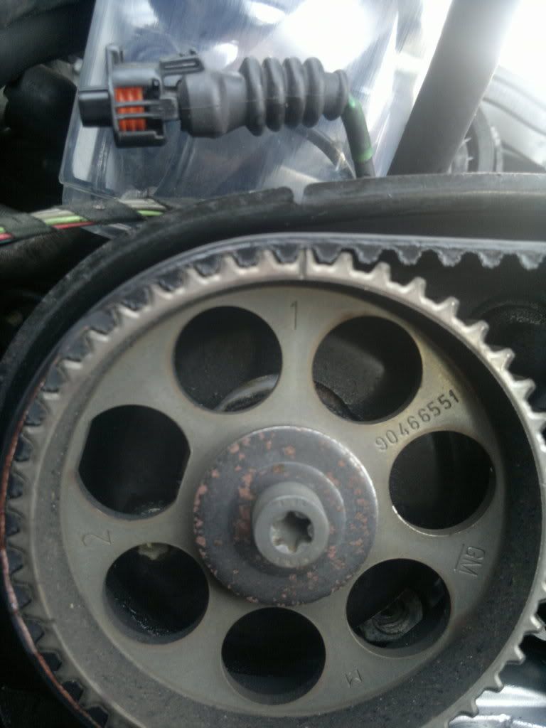

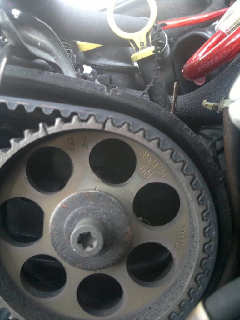

So, i stripped it all down again yesterday and lined up the markings expecting the worst and found this....
Going from my little knowledge of the markings, I'm guessing all is ok with them?  Not having the correct timing tools i can't measure it to be 100% sure...

The timing marks on the cam sprockets don't look to be miles out on the marks on the backing plate, but you really need to get the locking kit on it to make sure. I would have thought the tensioner would have been slightly more tight than that as the two lines lining up is a used belt, if you have only just changed it I would have expected it to be a little further around.

Tensioner does look a little looser than I would have set it for a new belt but that shouldn't cause the problem, although it will mean that when the belt stretches slightly you'll have some slack there  :-/

Neither the tension nor the timing are a cause for concern IMHO. Timing would need to be a tooth or more out to affect fuel consumption and more to cause knocking noises. Tension has relaxed to the "normal" setting fairly quickly but I've never checked it this early in a belt's life. It is now a "used" belt, after all. ;)  The relaxation is due to the teeth bedding into the pullies so quite possible that a few hours running has seen all the slackening there is going to be.

I dont think the timing marks are far enough out to cause any knocking, tension could be tighter, about 3mill past is about right iirc(trying to remember if it was yours i saw that looked spot on, might have been Joffs) apart from that theres no evidence to say anythings wrong in the pics imo.

The second sets of marks on 3/4 bank. Are those correct? Sure they are, as the part numbers are the same on wheel 3 and wheel 4.
So the other set of marks are for the other cam on that bank, if you see what i mean. 3 and 4 wheels can be swapped and have both sets of marks, to put it another way...?

Think your getting Paranoid now Ode Girl :-*   the mark nearest to the 3 is for Cam 3.      the mark nearest to 4 is for cam 4. so yes you have them right  ;D
Unless you removed the Sprockets and have not put them back with the locating dowel in the correct place ::)
