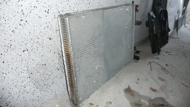

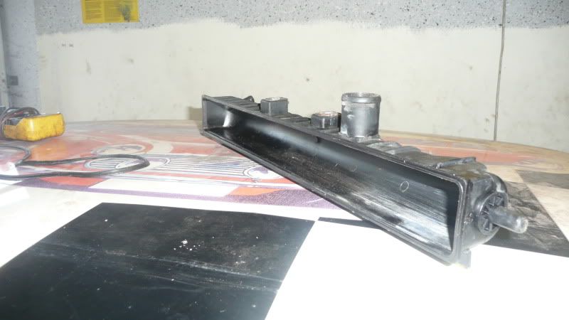

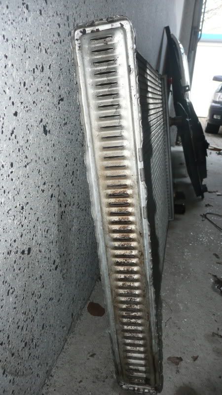

right had a hr today and managed to get the beeping rad off!!!! had to also take the middle rad off to get the coolant rad off (i assume the middle rad is a cooler for the power steering???? as when i undid the pipes that run over the coolant rad the fluid that came out looks very much like power steering fluid)
anyway i bent the tabs back and removed the plastic end that is leaking
as you can see all looks ok
the inners have not broke
and looking at the plastic end theres no cracks either

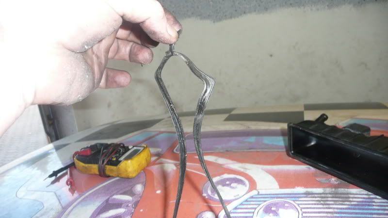

but then i looked at the rubber gasket
as you can see im holding the tear in the rubber gasket :-(
thing is can i get a new gasket??????? (for the end)
or can i remove it and replace it with heat temp engine sealant/silicon???????
or is the rad oppsed and just bit the bullet and replace it????
