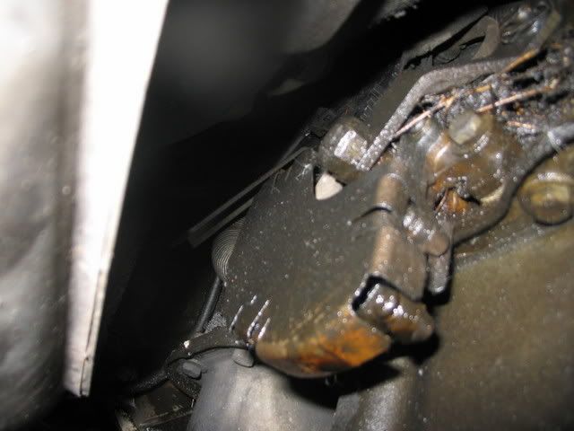

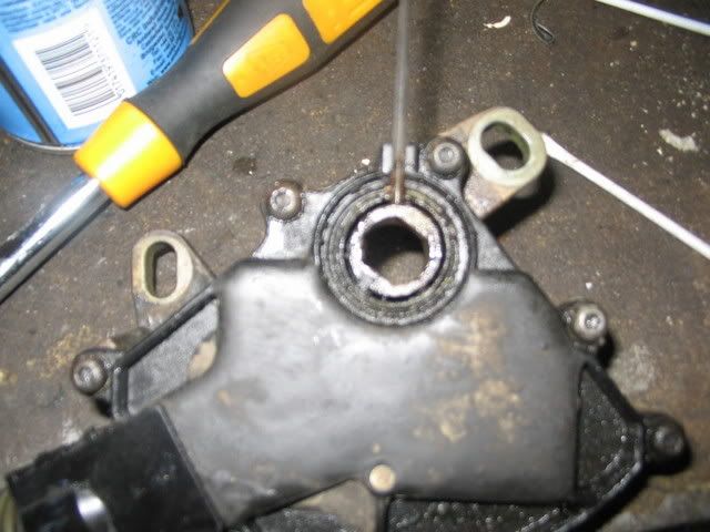

Lol clean it and reset the position of it.
Its easy to remvoe, a couplf of bolts and a nut as its attached to the side of the gearbox (passenger side)
Easy to take apart to and clean.
Here are a few pics which might be useful.
The last picture shows how you align the switch before tightening up the bolts (note, this should be doen once its on the box, the picture was taken like this just for clarity)

Gearbox in neutral.
Twist the switch body (bolts loose) until you can insert an allen key in the alignment slots as shown in the last pic
Tighten the bolts.
To set the linkage.
Set selector lever to "P" and ensure that the parking lock is engaged. Loosen the fastening bolt on the linkage. Press the selector lever on the side of the gearbox rearwards to the stop point (as far as it will go!). Tighten the bolt.
I would set the linkage before the switch.

1.      Put the car in neutral.
2.      Remove the selector lever from the mode switch.
3.      Remove the cover.
4.      Loosen the two 10 mm. mounting screws.
5.      By rotating the mode switch you can line up the slot in the mode switch housing with the selector shaft bushing.
6.      Insert a 2,4 mm punch (3/32 in) in the slot.
7.      Tighten the two 10 mm. screws.
Using a multi meter.
2.      Disconnect the mode switch connector. It’s located in front of the air filter box and it’s the biggest of the three you’ll find there. (black).
3.      Connect a multi meter set to resistance between terminals 1 and 4.
4.      Loosen the two mounting screws of the mode switch and find the range of electrical contact by turning the entire mode switch.
5.      Then fix the mode switch to the middle of that range and tighten the two mounting screws.
