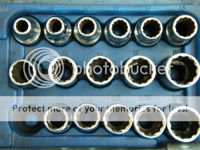

I've been using a Draper Expert 1/2" socket set for the last 16 years, it's only just now beginning to show signs of 'wear'...
As for locking wheel nuts, standard Vx. ones don't usually stand a chance against a decent 19 m.m multipoint socket, as pictured.

« Reply #11 on: 21 June 2011, 20:33:36 »
oh yeah,
Thats the one thing i forgot.
A multipoint socket is best.
Lots of impact sockets have only 5-6 points...or whatever it is.
Multi fits better
