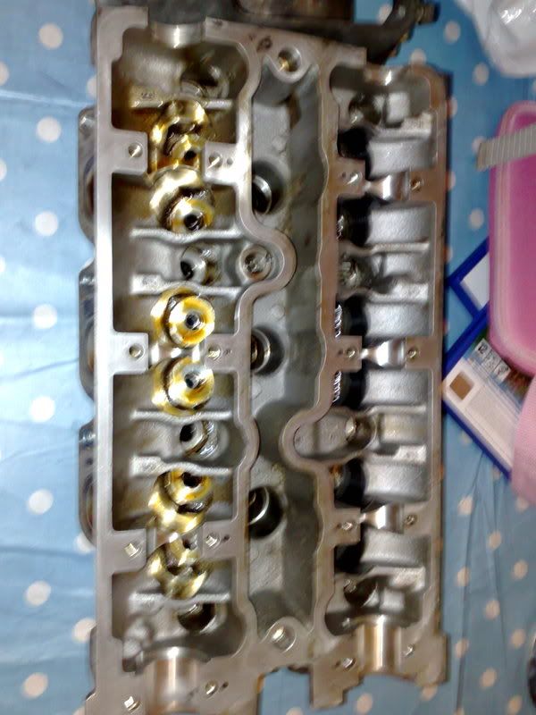

Re: Got my hopes up!
« Reply #10 on: 02 February 2008, 10:28:37 »
a bit fuzzy... but this is the 2-4-6 head I fitted...
  • Posts: 34123
« Reply #11 on: 02 February 2008, 10:33:42 »
Chances are its an early head as the later ones approx when the oil pump was changed, had some additional metal added between the plugs to allo the fitting of coil per plug modules (for the Caterra)
See here:
« Reply #12 on: 02 February 2008, 10:35:27 »
What do I do from here then - put the T vents from Max's car onto this one? (nb, the heads from his car also don't seem to have the CPP holes)...
  • Posts: 34123
« Reply #13 on: 02 February 2008, 10:37:46 »
When you plan to look at the fault......take the cam covers off as the first job and check the T-vents (at least one can be removed with the cams still fitted).
If they only have one hole in the side then fit the ones from the original heads, re-build and re-try.
If they are wrong then I would think this is the problem........the oil feed to the followers is being restricted.
