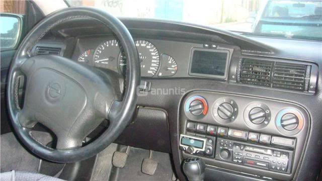

But just to show you my actual centre dash here is a pic:
Will they fit?

yes - BUT.
the mountings for yours is different to the woody one. You will need to cut yout existing one and make it fit into the holes of the woody one.
The screws mounting yours are behind your dials - just pull them off and you will see. You need to preserve the mounting points and glue the outer circles into the woody bit.
Not a job for the faint hearted as you will sacrifice your old surround. Sharp tools, a dremel and glue needed.
Off to photobucket now - back in a mo.
The end result is very good - let me post a pciture.

yes - BUT.

Rob I'm in Spain so can't take the car.... but "Varche" from the forum here lives in Spain and has the same dash in walnut as yours for sale but with the digital dials. And actually you've answered a question for me if they can fit my car.  From your pic I see they do. Awesome ;)
