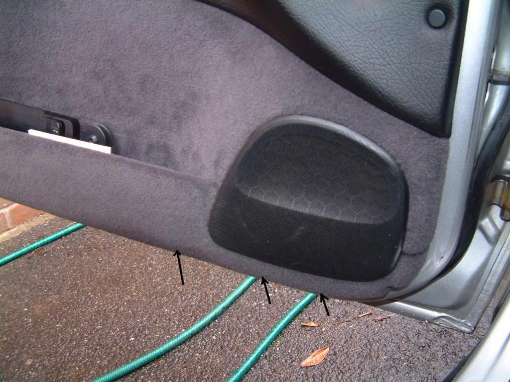

I have noticed recently that the front passenger door gets wet at the bottom where the trim ends(rounded bit of the side pocket and right up to the speaker.
All trim intact, the skin behind is intact and can not find any likely causes. Has anyone ever had a similar problem after a lot of rain?

Lou, can you post a picture showing the wetness you mean?
Don't worry about the 'jokey' replies, it's not you they're taking the pee out of.

ok, will take pic tomorrow.

« Reply #11 on: 07 September 2011, 11:24:09 »
Pic as promised.....wetness where arrows are

« Reply #13 on: 07 September 2011, 12:23:19 »
Wetness is below the speaker..

Re: Wetness at bottom of door...
« Reply #14 on: 07 September 2011, 12:48:25 »
That's where it would end up  :y
