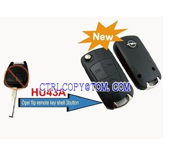

Well, they are not (or not seem to be) "genuine GM" flip keys, but there are modified flip keys compatible with our Omegas:
I have turned both my keys to flip keys this way. The keys are exact clones from the Insignia flip keys (which are the only Opel/Vauxhall flip keys I've seen). You can't tell them apart. They are excellent.
They are modified in such a way that you just have to switch the electronics and transponder chip to the new flip key and that's it.
Of course, you'll have to cut the blade. There are stores that cut keys just with the key code. No need of mechanically copying the old key.
I've bought my keys from this foobay guy, but later I've seen them for as low as 7$ in some obscure chinese page.
Beware of blade types and number of buttons. There are different kinds of blades. Mines where HU43A (they have "150" written on top of the blade). There are also flip keys to accommodate 2 button electronics.
Here they are. 9.45$ (5.77£ as of today, according to Google).
Don't know if the page is thrusworthy.
Great post, I did buy a Geniune GM one couple of years back with this intention, but was too much effort / impossible to get it to work.
This looks like it will.
Might give this a whirl  :y

knowing me as there seems to be no way to attach it to a key ring i would loose it within days ;D
There is a bit at the opposite end to the flip key bit the hooks onto your keyring.

Thanks for the reply, is that a hard cover over the 3 swiches rather than the soft rubber type on orginal fobs?

Martin Imber did that mod to 2 keys for me around year or so ago.
Mine are the 2 button type and the flip key works fine.We had slight issues with the key blade but Martin will advise if you do go that route.

Remind me what the gain here is?
For me, one is aesthetics. Other is the convenience of carrying a rounded plastic square vs a metal key shaped thing.
It's somewhat in the middle of both. Plastic is rather hard than soft, but there is a good clicking feedback from the buttons. A period of aclimatation is necessary, though.
