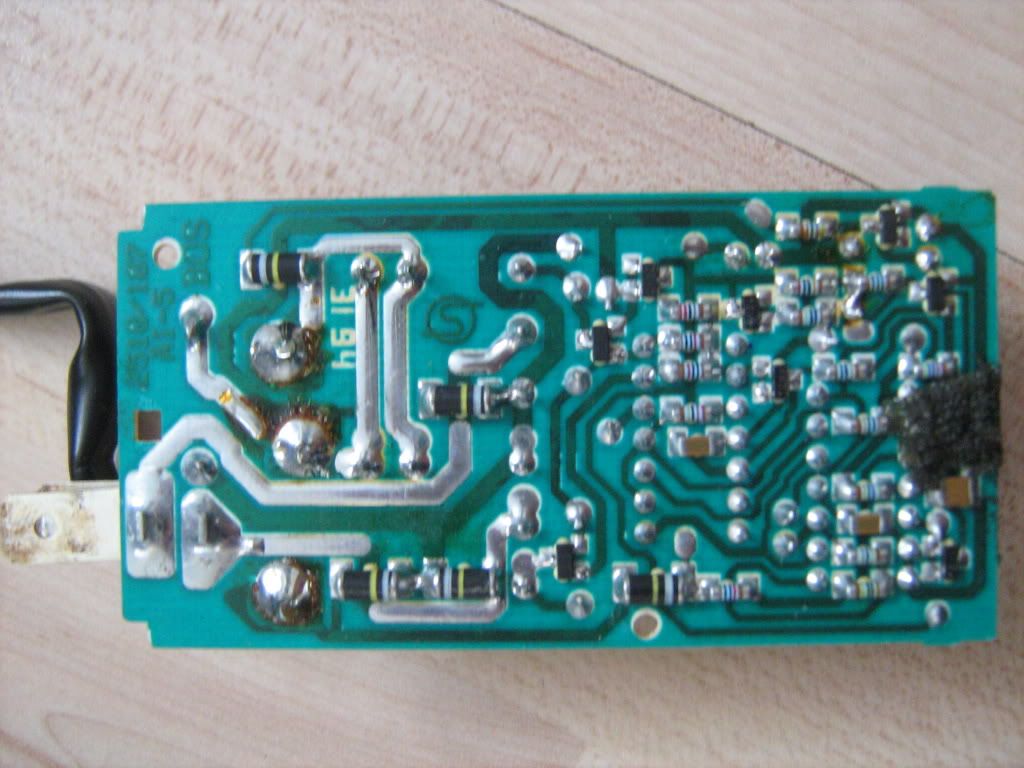

I've removed the blind from the shelf and slid the pcb out of the black plastic box (controller I assume) and when the switch is pressed the relays are just clicking :-/

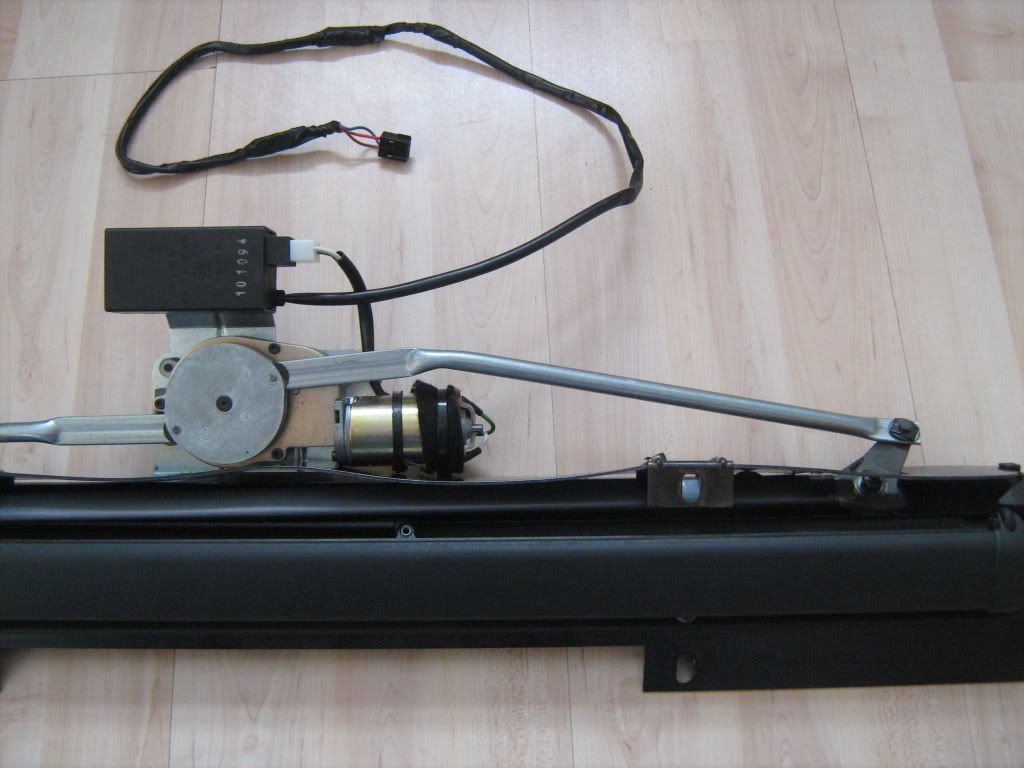

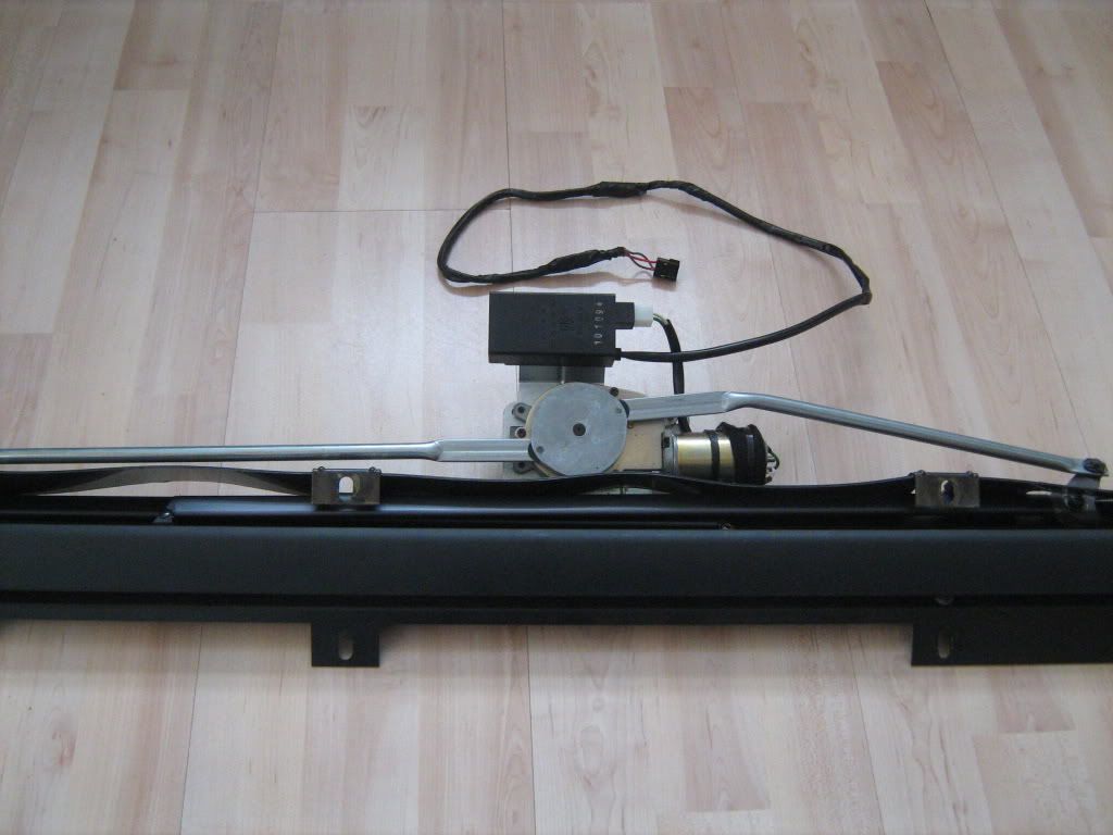

Pics below of pcb and complete blind, does it look ok, are the arms the right shape and in the correct position, does the pcb look ok?
I did notice that the heads both on the control box mounting screw and the three mounting screws which hold the plate to the blind have been attacked with a very ill fitting screw driver.........someone has been dismantling it in the past :(

The PCB does look like it's seen better days.  :(

I suspect you will have issues with yours again as the arm on the right side in the picture is bent and needs straightening.
Seen this happen on a few following postage (and this is no fault of the packaging) and appears to be due to the awful way the postal lot treat them
What happens when this occurs is that the actuating cam goes over centre and the motor cant get it back.

QuoteI suspect you will have issues with yours again as the arm on the right side in the picture is bent and needs straightening.
I wondered whether it should be like that, I might try and straighten it out...
Can't blame postie this time as it was personally delivered in the boot of another members Omega
Easy enough to straighten.
Remove the torx screw from the spindle and the clips from the actuator end and you can take arm assembly off and get it in a vice....gently straighten it bit by bit and keep moving it along in the vice a mm or so.
And how do I know this.....I had one (the wrong colour) from markie Mark adn it was perfect.....I got one in the right colour and it was bent and kept jamming....
