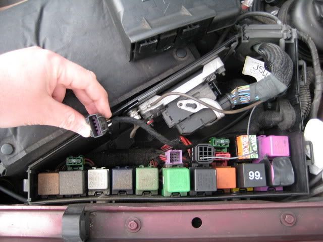

Right Question About Facelift (03) Omega 2.2dti CD model
I noticed today on another Omega (CDX) parked next to me that his wiper stalk had a small rotary switch on it to vary the intermitant speed.
QUESTION.
Is it just a matter of getting hold of a stalk and fitting it to my CD model?
If NOT what else do I need to get and where will I have to fit the other things.
I have searched the forum and only found comments about Pre-facelift / VW learning wipers and rain sensative models.
Cheers (Also if it is just a stalk where do I get it from or has anyone got one spare)

we have a maint guide on this....
you need stalk
relay
and some extra wiring  :y

Read this. particularly the last post re; VW relay
http://www.omegaowners.com/forum/YaBB.pl?num=1279100997/3
Re: Variable Speed Wipers
« Reply #3 on: 14 September 2010, 22:17:15 »
or do it the cheap and easy way .. just change one relay .. :)
(I'll try and find Kevins thread)
http://www.omegaowners.com/forum/YaBB.pl?num=1281183577/6
and it works .. I've done it ..  :)

Deffo agree with the 99 relay, takes all of two minutes to fit, that includes unlocking the car and opening and closing the bonnet.

Where is the relay located for the variable speed wipers on the Omega? & has anybody a GM number for this unit please?
Cheers
Cheers
its where the one with 99 is normally (thats the VW part)

« Reply #10 on: 15 September 2010, 09:28:35 »
Cheers Jimbob,
I have just checked mine  [ Elite ] & it is slightly different layout, I have the lower orange relay but have 3 fuses next to this, where your 99 is I have a yellow relay with an Orange with this & a 50amp fuse next to a 40amp fuse, I have no other relays after these.

« Reply #11 on: 15 September 2010, 11:00:09 »
Relay is the tall yellow one

Cheers Jimbob,
yup, different models will have different bits depending on options fitted,
The 99 is normally a tall yellow one and will be your wiper relay :y

i would say th "99" VW relay is the best option for ease of fitting.
(got it off ebay for £12.50)
Works a treat for me.
