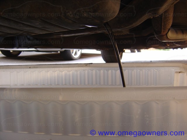

You should see the oil poor out like this:
It will very quickly become a slow trickle, but leave it for about 20 mins to make sure all the oil comes out.
